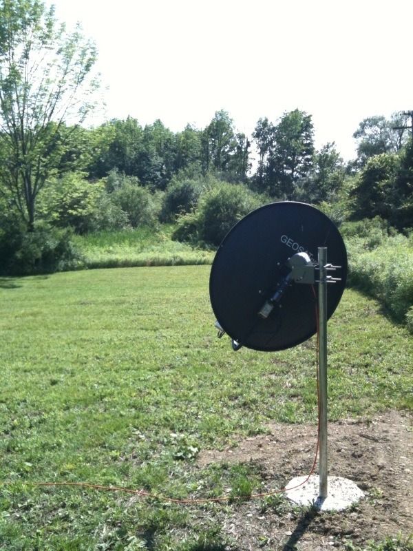

Since then, I've built and moved into a new house. I used to love looking for news feeds when big events were going on, so I decided to step into the Ku FTA world. I just picked up a 90cm GeosatPro dish, Invacom LNBF and a used Coolsat 6000 of ebay. Up and running for around $250 total. It's amazing how cheap this equipment is!
The other thing that blows me away is USALS and how tolerant these dishes are to poor alignment. I installed several C Band dishes over the years, and finally got good at aligning them fast. If you have never done that, trust me, USALS is amazing. It took me about 5 minutes to have the dish tracking from 125W to 30W perfectly. I've spent hours peaking C Band dishes.

Welcome, turbotoy.
Thanks for the pics. What kind of motor do you have?

Thanks! The motor is a DG280.
Poor choice of words on my part in regards to alignment. What I really meant is, the dish can move around a significant amount with the signal appearing to stay near maximum. As expected, there is far less "focus" than there is with a BUD. When I first felt the amount of backlash in the motor and the amount of resulting play in the dish I thought there was no way it would work. It's fine.
That said, I'm sure I could have just got lucky.
My method was... Locked the motor to my latitude per the scale on the motor, then moved the motor using USALS to 72W. Punched in a hot transponder and scanned the sky by moving the dish (not motor) up and down and had it within a few seconds. Went to 125W and had to make an azimuth tweak. Went back and re-peaked elevation at 72W, went back to 125W and all was fine. Tried Hispasat at 30W and, to my amazement, it was dead on. Locked everything down and went into the house to start blind scanning.
Nice having one coax to hookup for alignment at the dish vice all the motor and polarotor connections!

I also have a GeoSatPro 90cm and a DG280. I also had hardly any tweaking to do to achieve near-perfect tracking. The scales on those two items are dead on.
