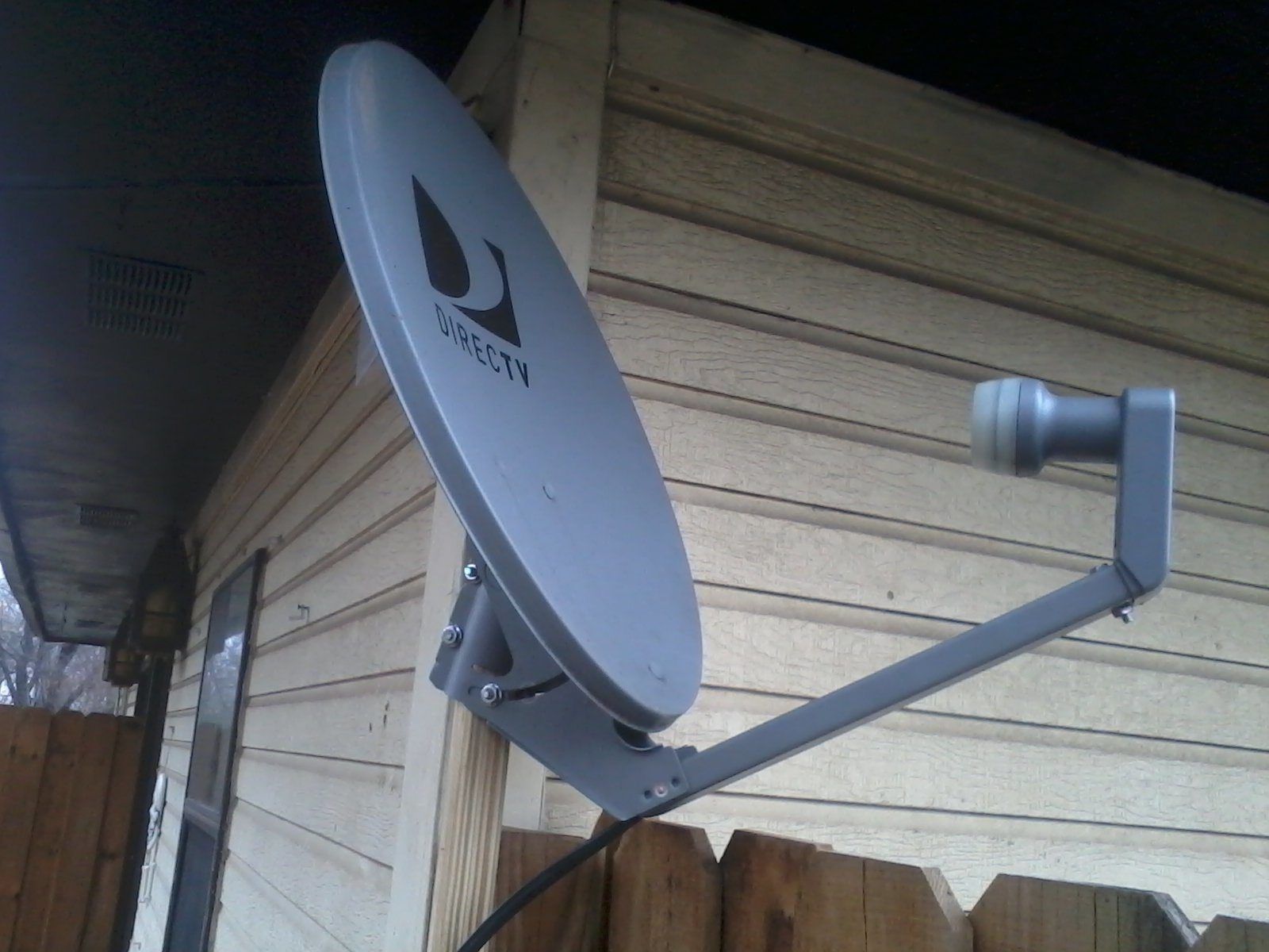

By the way, i pointed the dish towards the southern sky. I don't know how to correctly set the tilt, but am just trying to get
a signal going before any perfection is needed.

How far did you move? If a short distance, say under 25 miles or so, the alignment settings on your dish shouldn't change. First, check to be sure the mast is plumb, this is very important! Then point the dish at about 207 on your compass. Check to see if you have any signal. Slowly move the dish left and right and see what that does to the signal levels. You should see a change. It doesn't take much movement to get a difference. Good luck and come back and tell us how it's going!
x6,
As Chip said, you need to be pointing the arm of your dish to 207 on your compass and you need to have an elevation of 48 degrees. That means that you need to get your base perfectly vertical and then set whatever elevation markings you have to around 48. The picture makes it look like your mounting is quite a bit off vertical (but that could just be the way the picture was taken).

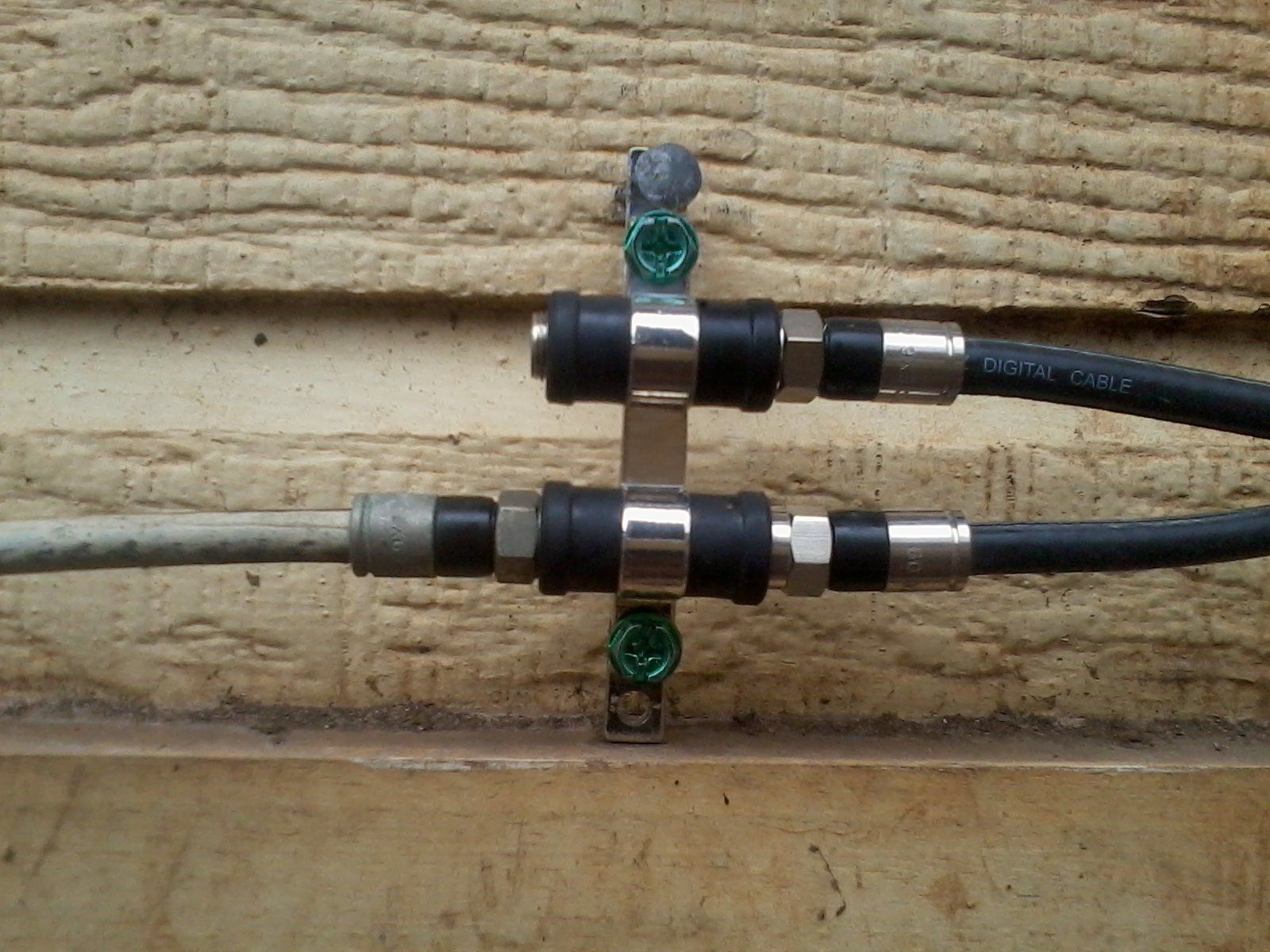

Also, your first picture is a grounding connection not a splitter. When you get things working you need to run a grounding wire from the green screw to something grounded. Alabama is known for thundershowers and you don't want any stray voltages on your line.

Bob, now that you mention it, I don't think there is even a mast in that second picture! You can tell the channel for the mast on the mounting bracket is far from plumb. Compare it to the corner board of the house!
I totally agree. It looks like it is sitting on a white wooden pole. But, again it is difficult from the picture to be sure.

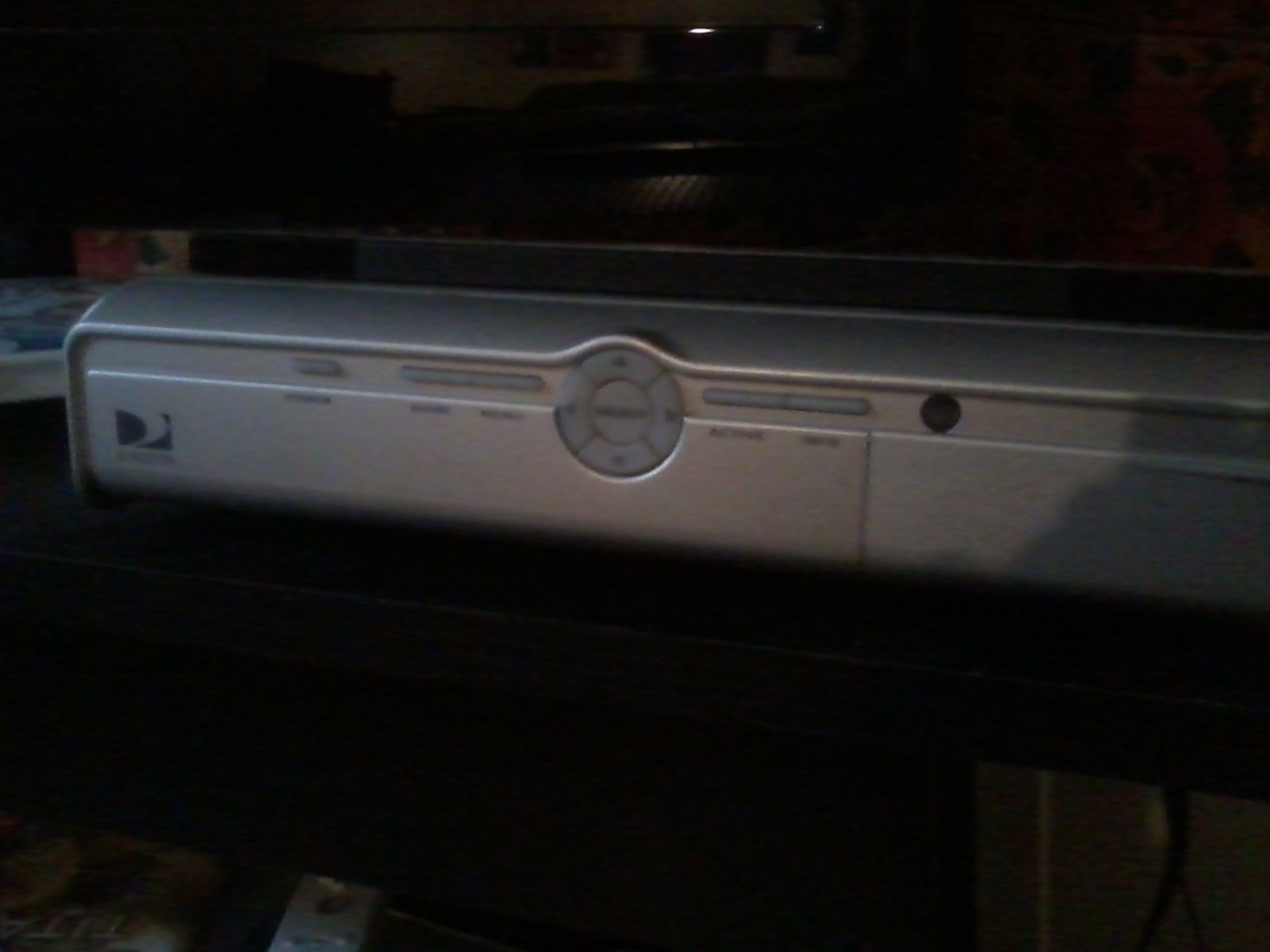

Knowing the model of the recvr and the dish your trying to use would be a big help.
I also have never seen that recvr.
The Dish your using will get SD only from the looks of it.

The receiver is a D11, it's a standard receiver. Nothing fancy

Thanks for the replies, yes all the equipment is basic level, and was working at the other residence which is about 15 miles away.
It's good to hear that the cable splitter seems to be only a grounding connection on the 2 screws.

You are right about how the dish is mounted, right now it is just placed onto a pole and tightened down, pointed towards the southern sky.

I think we have done that. First you get a pole of the correct diameter. (The one off your old house would have been nice.) You mount it to something solid (or put it in some cement in the ground). You make sure it is vertical. You put the dish on top of it. You aim it as we have described. You enjoy your DirecTV service. That is really all there is to it.

If it's the old dish, like I think, it used a 1 5/8" pipe/post.
They newer Slimline dishes use a 2" OD pipe/post, in case you decide to used a different dish.

According to dishpointer.com, it should be about 48.

As Chip pointed out, your elevation should be 48. You can see the setting you need with this website. Just make sure your address is in the top box and 101 DIRECTV 4S is in the second box.
Once you get the pole setup correctly, the rest is fairly easy. But, it is also one of those things that is only easy after you have done it.

I'm going to recheck my mounting settings, it seemed that at the old residence the angle was around 50-55 on the percentage reading on the angle mount.
It isn't a percentage reading -- it is a angle (in degrees) relative to the horizon. The setting means absolutely nothing without a plumb mast in the sleeve.
Understand that this isn't a "general direction" thing like a TV antenna. With a dish, you're goal is to focus on a something that is a little over 22,000 miles away. Half a degree one way or the other makes a huge difference.
