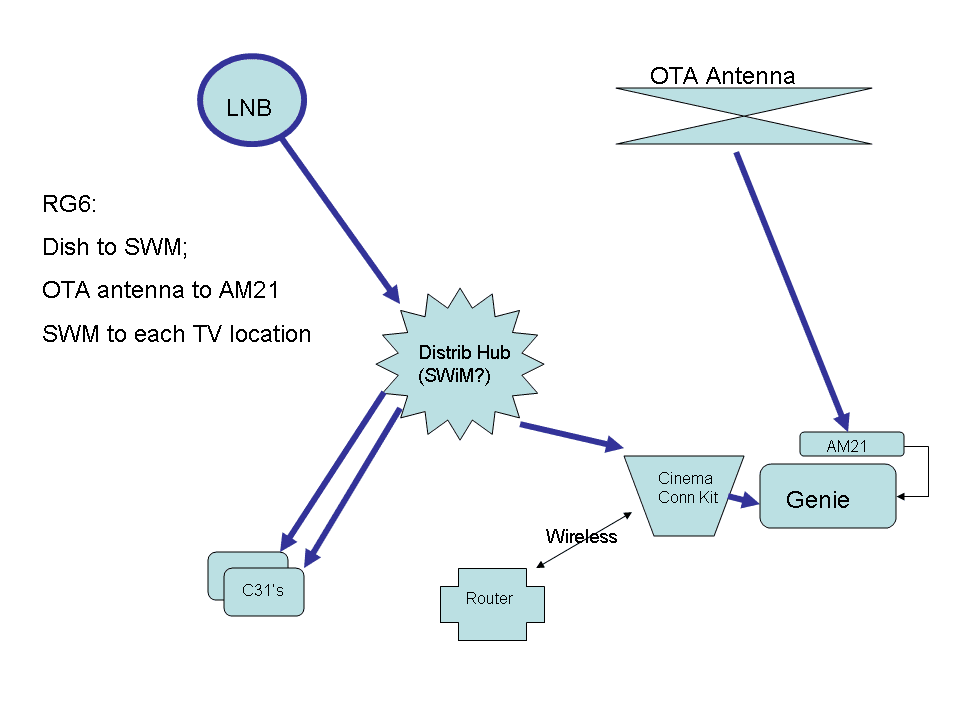

I understand an AM21 will work with the Genie to pick up OTA and distribute to the clients just like any other channel, but the question I cannot find an answer to is this - does the feed from the antenna to the AM21 run point-to-point, or does it need to go to the SWiM multiswitch thing?
I am planning to pre-wire the house because 1) I HATE cables stapled to the outside of my house, and 2) the layout of our house makes for some "interesting" wire paths. I don't know exactly where they will put the dish since the previous location may be unusable due to neighbor's tree growing much larger. So I am planning to decide where I want the "hub" to be, based on ease of wire runs, and then we will just need the installer to run a cable from the dish to the "hub" location. Just trying to figure out if the antenna cable should terminate at the hub or the AM21 location....
Thanks!
:welcome to Satelliteguys!
The line for the AM21 goes directly from the antenna to the AM21.
So if I have a new install with a Genie, AM21, two Genie Mini Clients, and the "Cinema Connection Kit", all I would be looking at is single RG6 from dish location to a central location (where the multi-port device is located, and a single RG6 run from there to where each TV will live, and a single RG6 from my OTA antenna to where the AM21/Genie stack will sit. Correct?
yup pretty much
