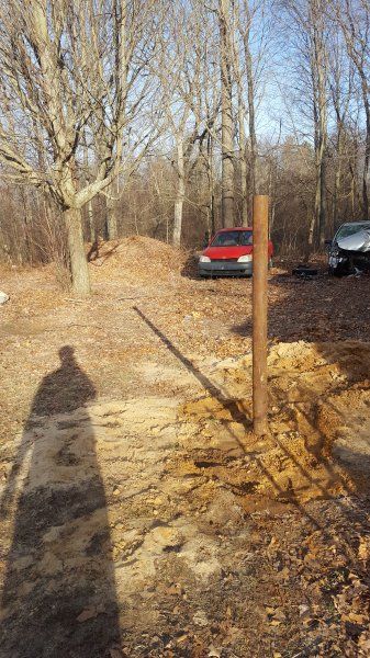

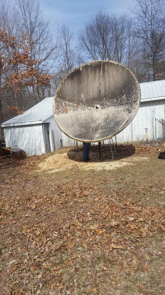

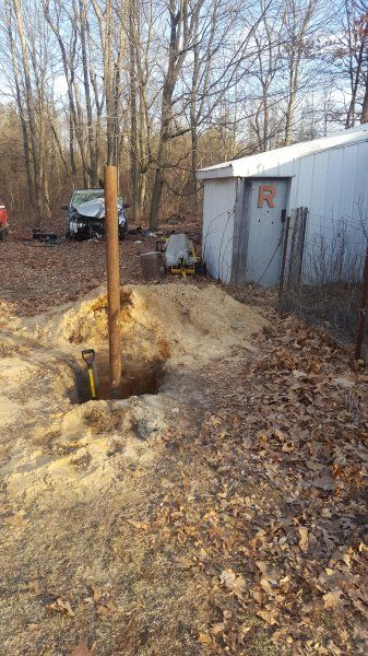

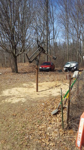

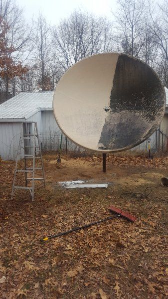

Some quick photos..
Patience....
I recommend letting the cement cure for at least 4 days to a week. A large dish will loosen the post in the uncured cement and cause unnecessary problems in the future. I know how it feels to be anxious to start the assembly! :)
Photos or it didn't happen! LOL
What did you use for anti-rotation? Weld on tabs, rebar or through-bolts?
Taking the welded on tab approach. This is only a temporary home for it. (plan to move in 7 months).
Thank you. That is nice to know. This thing looks like it could be extremely heavy, and I don't want it to crash down and hurt somebody. I have read that they can be misleadingly heavy as far as appearance. Thanks, and good luck with yours!
Your mount is pretty similar to mine.. Be aware that mount probably weights almost as much as the dish. Personally if you don't have more then 3 people I recommend taking the dish off the mount. And then taking the mount off.. Because I feel it would be VERY heavy combined.
