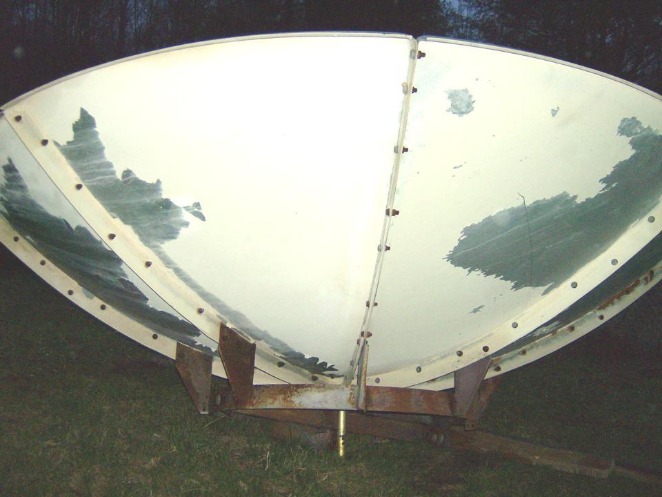

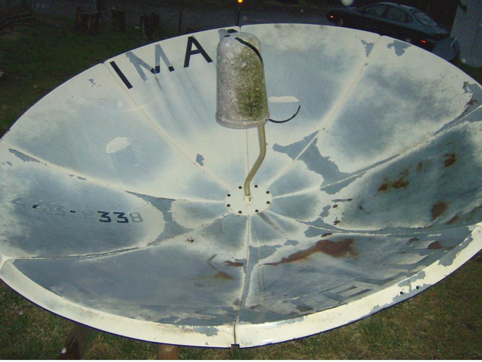

i was foraging the blacktop jungle, and discovered this hidden in the open!!
it measures about 9 ft wide and is galvanized steel solid. it didnt even try to run away so i bagged it and brought it home to graze with some of its pals in my back yard. (translation - guy gave it away)

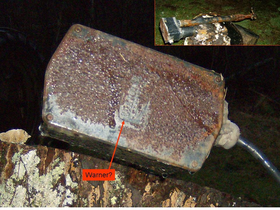

I cant seem to find any conclusive model marks on it. (imar?) the actuator seems to have the word Warner on it .
its a little heavy and trying to hold it by the rim resulted in bending the outer edge slightly.
anybody have any ideas on who makes it? if i get desperate enough, i may try that phone number on it.

i called the number, got a lady with a really nice sexy voice telling me she did not know anything about a dish, lol!!
probably thought i was a weirdo, well, my wife would probably agree...
i have done searches for galv dishes, but come up dry.

I posted a pic of one like that several years ago. It was identified as Laux Beta 9 with a Seavey feed.

heh, i just did a search on it, no wonder it was hard to lift by myself, it weighs 300 lbs !!!:eek:
i had to get a buddy to help me get it in the truck.

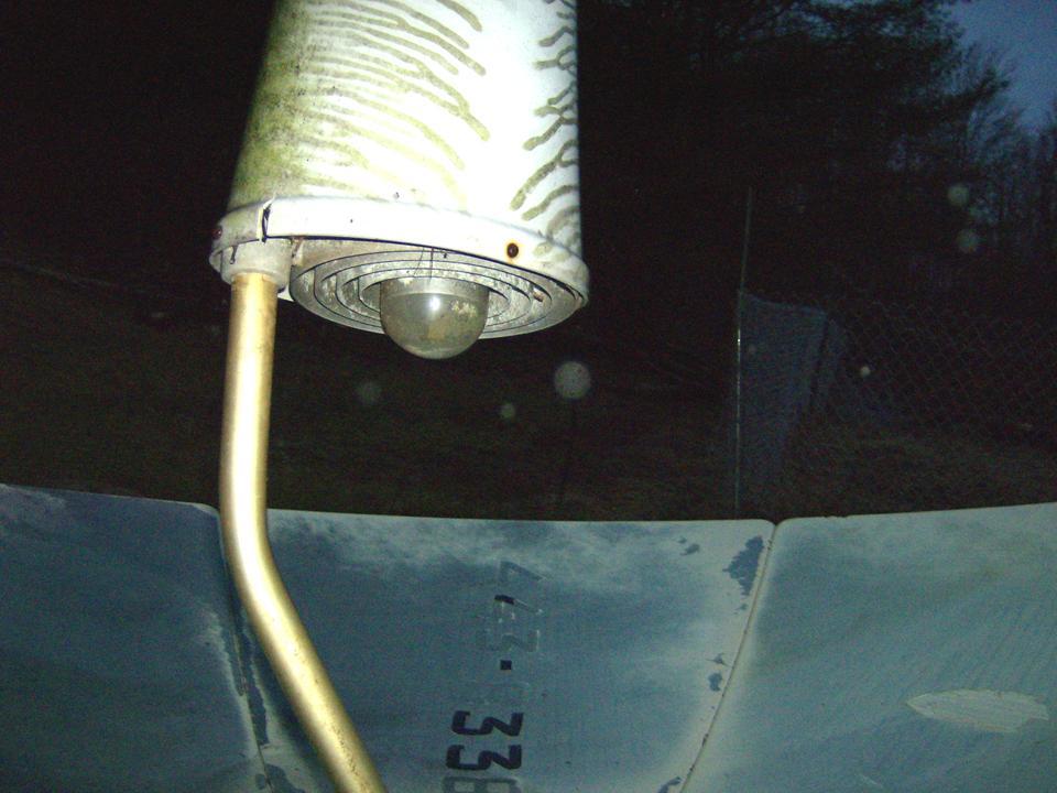

That feed looks like a Seavey. If you are lucky, it is an ortho. The Seavey orthos are almost as good as an older ADL.
would there be a problem with using a modern LNB?
i use bandstacked for all others...
If you want to use a modern Lnbf, it should fit in the scalar, but some modification may ne necessary. If you are talking lnb, then they should bolt right on to the feed.

I am setting up my Laux Beta 9. This is what i have so far. The jhook came loose in transport and i lost the original Focus distance.
The Seavey lnb was toasted. completly shot. I modded that 4 ring scalar for one of my eagle aspen bandstacked lnbs.
According to my measurements for F - the C=22.25" , the D= 9' or 108" and the calculation yields aprox 32.75" as the F.
I set the scalar there for now.
Am i missing anything? I hear this dish has some quirks. That maybe the modern Lnb i stuck in there will not be as effective as that seavey.
Thanks
yep.. that looks just like my beasty 9 foot laux beta.... although the mount looks smaller... I was told by the original owner its from 1986
I like it.. I get in just about anything I try for.. I have a modern lnbf on it (c and ku)
would you be able to measure from the scalar to the dish? i am curious if i am in the zone for the focal distance?
