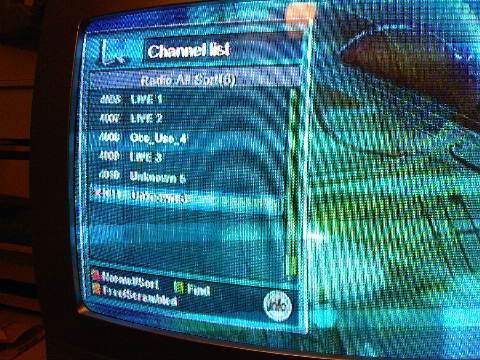

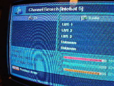

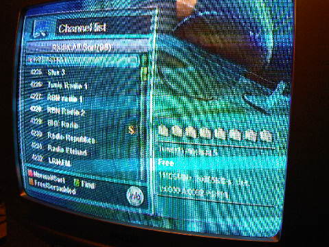

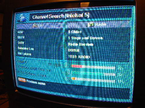

Thank you. Yes I was at 111W, not 97W. Then tonight only I correct all the angles and scanned the channels again. Haleluyah/alhamdulillah I found it! I has never been happy as I am now despite some issue at the office ;-). This discovery comforted me a lot :-).
When it was scanning I saw so many familiar TV channels (and radio stations) coming in. However when the search was done I could see only 90 radio channels. They are all listed in Galaxy 19's content.
I'm not too worried now. Some friends above said that it could be format issue (MPEG4, etc) or that I could enter the video PID manually. I believe I may fix it shortly.
BTW my receiver is Viewsat VS Pro. Can you please elaborate more on doing it manually? What are PID, FEC?
Some photos FYI
IMG01270-20121127-2007.jpgIMG01271-20121127-2008.jpgIMG01272-20121127-2159.jpgIMG01273-20121127-2215.jpg
