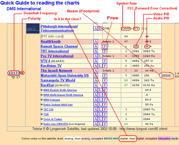

Ok..right now I'm checking out the free american channles on lyngsat. Now I see HBO, Encore West on Echostar1 and ABC,CBS,CW,NBC,Fox on Galaxy 16. The beam section is not clickable for either of these sats so I caan tell if my area is covered..but I would like to know if I would be able to get both sats with an 8 foot dish and motor.
NO those are PAY channels anyway :(
There are some channels ITC (In the Clear) on the Echostar satellites NASA and GOL TV, others come and go.
So why do they say they are free on lyngsat ?? The "F" is there in video encryption and the say digital clear.
I see you edited your post to include G16 :)
Yes there are FTA networks there on C-band (4 digit Freq. need a 6' dish min. here)
Thanks....will check out lyngsat some more and see what other channels are there on Galaxy 16 :D
