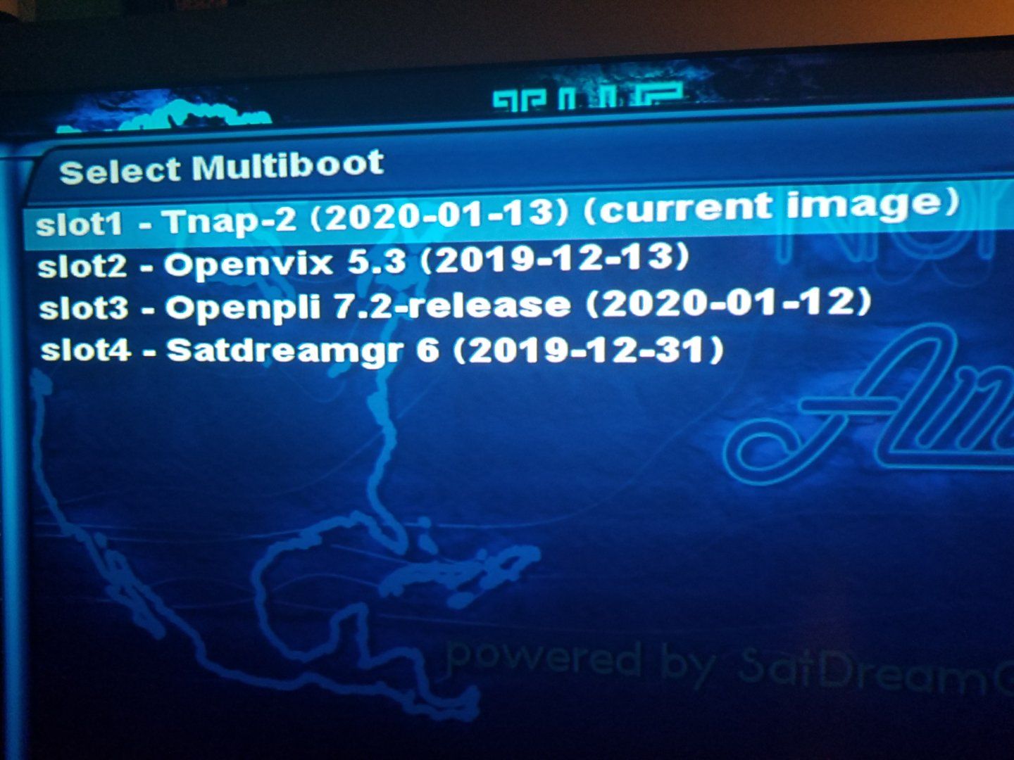

I put these images in my slots:
Slots
As mentioned before I tried the openvix and got locked out because I couldn't see the screen.. it was at the wrong frequency or resolution. I was able to use the window on the STB to change the video settings so I could then read the screen,
I tried another image.. The Satdreamgr.. initially it did the same thing.. unreadable screen. But then after a few moments it lowered the resolution on its own. This image was strange. It did not have a lot of features. I decided to try the last one.. openpli.

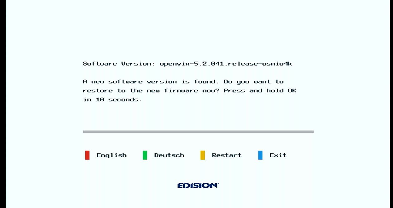

It booted up again with the scrambled screen.. the STB window had some set up options, but I could not get the resolution to change as before.. I then tried my restore USB to get back to factory default.. Although the white start up screen was rolling (as in my Youtube video), I could make it out. I saw a thread where a member posted a picture of it.

Great.. all I have to do is push and hold down the OK button and I should be go back to the factory Tnap-2. I tried it.. no go. As soon as I pressed the OK button it went to the unviewable openpli.. (maybe I did it wrong.. maybe I should have waited 10 seconds??) I started scrolling through the window again and found the multiboot menu. I was able to choose slot one and get back to Tnap-2 again!

If the ok for 10 seconds would have worked you would have overwrote slot 1 with openvix so it was good it didn't work. that is what the white screen is asking if you want to flash emmc.

I think that SDA_FL_USA thought the screenshot of the OpenVIX confirmation screen was taken on your system.
If the file on your USB thumbdrive was TNAP, that is the image that would be written.

All right sorry about that misunderstanding that makes sense why the ok for 10 seconds did not work with your backup of Tnap2 because there is no emmc image file created with BackupSuite.You have to use BackupSuite for restoring a backup or turn you backup into a multiboot image by put the backup folder on your windows computer then open the folder and you will see another folder named osmio4k or osmio4kplus. Right click that folder and send to compressed zipped folder. after the zipped folder is made rename whatever now you can put the zipped multiboot backup in the downloaded_images folder and flash to any slot with the Flash image menu.
