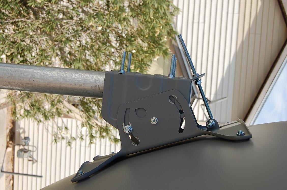

Now we have the right pieces, it's just that the puzzle likes to move around. BTW: to any member considering buying a 4 foot dish, I love this GeoSat Pro that I bought from one of the sponsors at the top of the page. I can loosen all of the bolts for side to side adjustment, and the dish does not slip because of a metal tongue that protrudes over the top of the mast. This seems to me like a really nice design feature, that I had not noticed when the motor was in the way (yes, the motor is out of the mix until I can get a handle on this whole thing). Another nice feature is the rod that is used for elevation. I can completely loosen the two nuts on the side, and make adjustments up and down just using the rod. When I am ready, I tighten the nuts on the rod first, then go for the two on the side. Love this GeoSat Pro!

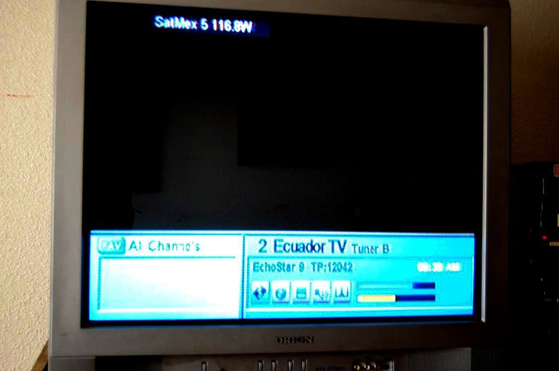

When I turned the set on this morning, I got another surprise: Four more pay stations showed up, but they each had a label at the upper left of the screen "SatMex 5 116.8W", even though I had selected EchoStar 9 when I ran the blind scan. See the photo, this is the second of four, ID'ed as "Equador TV". The screen was black.
Now can anyone tell me what I'm doing wrong?

Remember the receiver is not smart enough to "know" where it is pointed.
When you scanned, you selected Echostar 9, eventhough it may be pointed at a different Sat.
Looks like you have SatMex 5 Locked, with room for improvement.

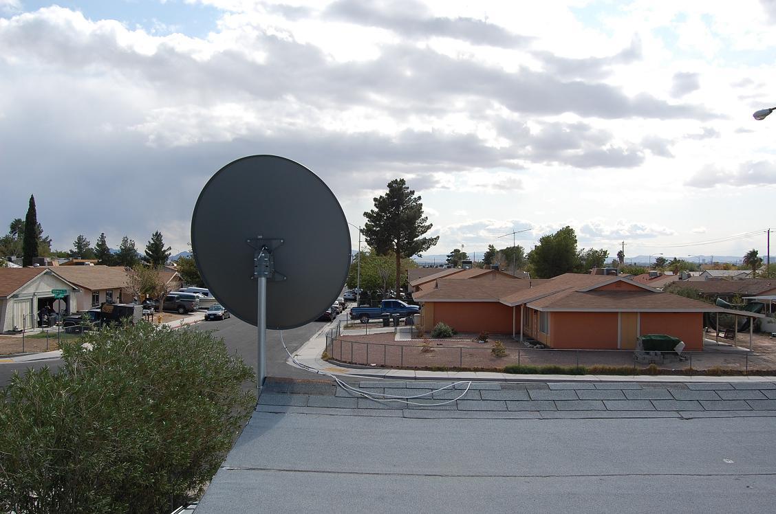

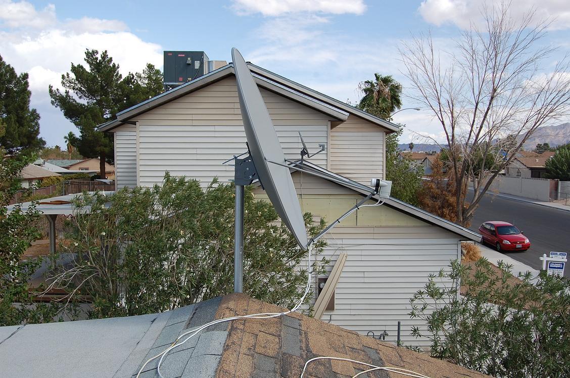

Okay, in photo 320, I was going to stand due West of the pole and take the shot aiming due East, but by stepping about a foot to the South, I was able to include in the background, the dish on the abandonned house East of us. I would guess that the little dish is pointing one, maybe two, degrees higher than ours.
In photo 321, I was going to stand due North of the pole and shoot straight South, but that would have put me with my right foot on the roof and, well... you can guess the rest. I moved about two feet West of the edge for the shot.
In photo 322, I was concentrating so hard on getting the little incline guage in focus, that I didn't realize I was holding the camera crooked. The pole is aiming straight up and down. The motor was removed over a week ago. The point of the "teardrop" indicates 49 degrees. Our home zip code is 89115.

Thats almost your True South Sat but, ince you do not have a motor, what is your goal?
Looks like you have locked SatMex 5 @ 116.8.
If your pole is 1 7/8" then each degree Az. is about 1/64th" on the pole.

Was that a scan of channels or one info page?

That was a single channel. 159 pay channels are showing up, and 25 pay radio stations.
