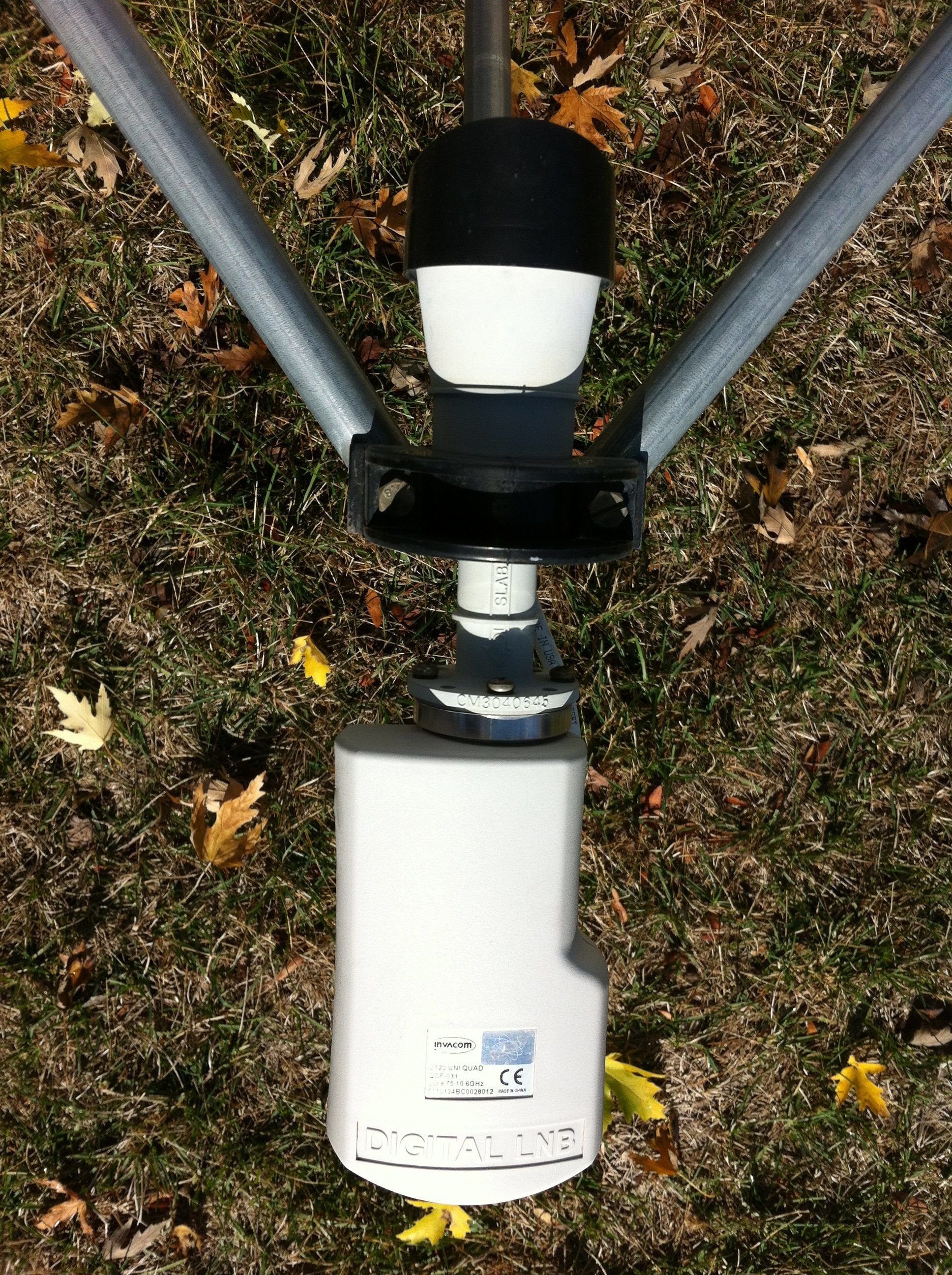

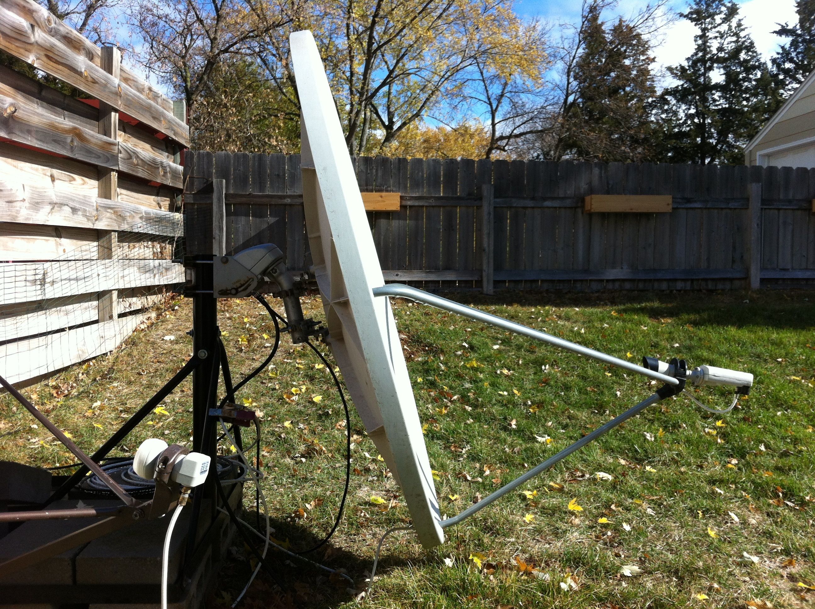

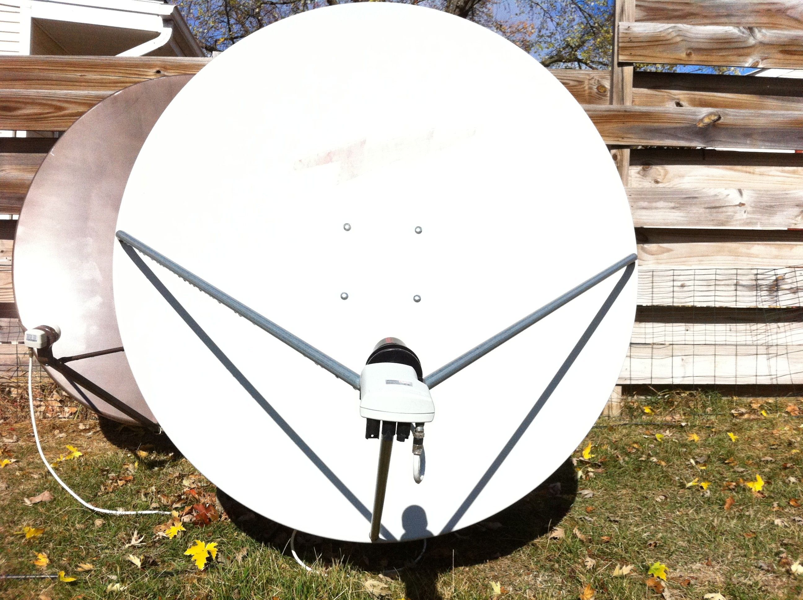

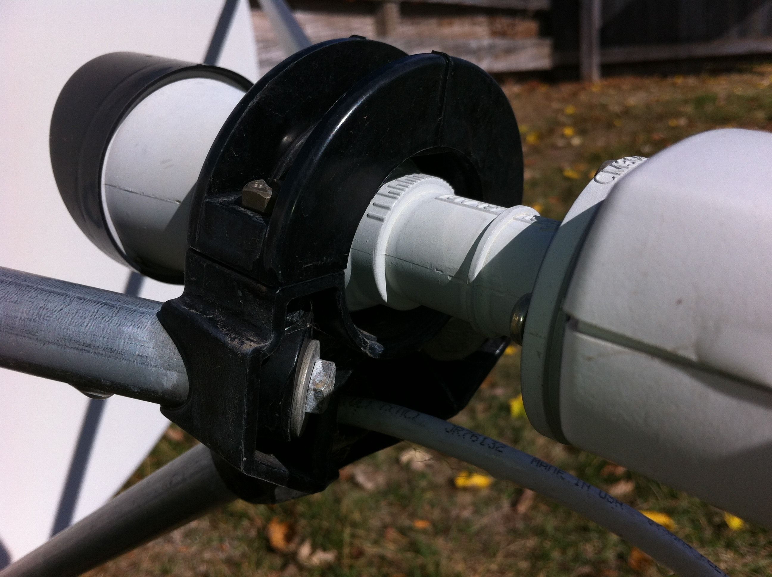

The last picture shows how I have the feedhorn pushed closer to the dish. I don't think the arms are bent or misaligned. Does any of this look off?

Is that a NON-Primestar lnb, mated to a Primestar feedhorn? That could explain it right there; feed mismatch. Your arms and such all look fine from what I can see
Or it's also possible that you have the wrong elevation set on your dish, and when you pushed the feed closer, it adjusted for it, but then it'll be using less surface area of the dish.
It's an Invacom LNB. Why would it matter if it's a Primestar LNB? They mate just fine. I will check my elevation and motor's azimuth position on the pole. Thanks for the suggestion!

Brainstorming theories, just tossing out theories... Sometimes you brainstorm a good one among the chaff... I'd think the elevation one is probably closer to the good one, since the arms appear to be mounted properly.
You probably noticed I have a NPRM on the ground supporting my dishes. I wonder how much the ground moves. I'd put up a pole in concrete, but my wife doesn't want a mound left over when we sell the house.

For comparison, measure from the top lip of the dish to the top front of the feed holder. My Pstar 1.2's(Channel Master MOLD#1.2M-1) measurements are 48 7/8 .
I'm not using the factory feed but matched the factories feed location 1.5 inches towards the dish face from the dish side of the feed holder. Found that's where it worked the best on weaker signals. (couldn't see any change on stronger signals)
BTW- what's the feed throat cover look like? Dirt can attenuate.
