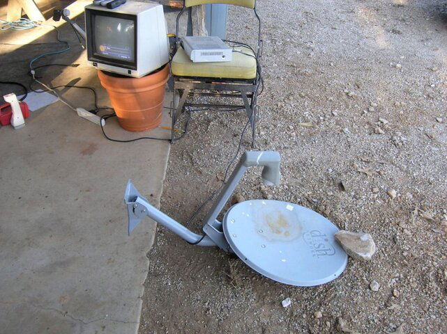

For the sake of nothing else to do, I tried pointing an old Dish300 (inverted) at Nimiq1 last night to see what radio stations I could pick up from Canada. Note: Inverting the dish makes it a whole lot simpler to aim. Basically just lay it on the ground and move it around a bit. :D
Dialed in and got 80 strength and 45-59 quality.
After a blind scan, I picked up 1 Canadian weather channel on the video side and nothing on audio. Everything else was scrambled.

Yep.. I had errands to do.. sorry... When I got to it, it didn't take but a few moments to dial in the right bird. Running about 45-47 quality.
It looks funny laying on the ground..

I attached a pic of the inverted Dish300 pointing at 91'. Thanks for the info.

Mark,
I really like the way you have that dish mounted, I am going to have to remember that method ;-)

I love the mounting job!

The rock keeps it from rolling... :p
I could actually remove the mast and just have the dish and LNBF arm. When it rains, the birds could use it for a birdbath too. ;)
It is by no means permanent. But with the low profile, it would be good where you wanted a less conspicuous footprint *except* where it snowed.
A ¼" hole drilled in the center pan would probably provide adequate drainage.

And all those years I carried a tripod in my RV and carefully set it up. Who knew all I needed to do was to throw the dish on the ground? :) I'll have to dig out a spare DSS dish this weekend and try this.
If the HOA complains about dishes, with this setup you could drill the hole and put a small hose on the LNB arm, making a nice decorative (and maybe even functional) fountain dish for your garden! :D
Unfortunately water absorbs the signal and it would not work as a functioning bird bath.
Every time anything as big as a Blue Jay landed on the dish, you would experience signal loss too. :p
This might be good though for campers... Now all I have to do is patent a bracket to hold the inclination and use a lazy susan(small recliner base) for azimuth. :D

The focal length is critical to the size and arc of the parabola. If you are going to make a dish, it is going to be a pain to get the arc smooth and then focus the LNBF at the right distance.
You could probably mold one to the existing pan of a 300/500 with body putty and screen. I don't know how sturdy it would be.
I tried holding the DBS lnbf over my inverted winegard 30" (to see if I could boost the signal) and it took me a good 15 minutes to find the proper focal length and offset. I was only able to get quality for a few moments since my arm wasnt steady. It was a great deal longer than the Dish300 focal length.
If you've got the time and patience, go for it, but I think it would be frustrating.
Another option might be to cut a larger hole(1-2") in the dish pan and epoxy a fine screen mesh over the hole.
