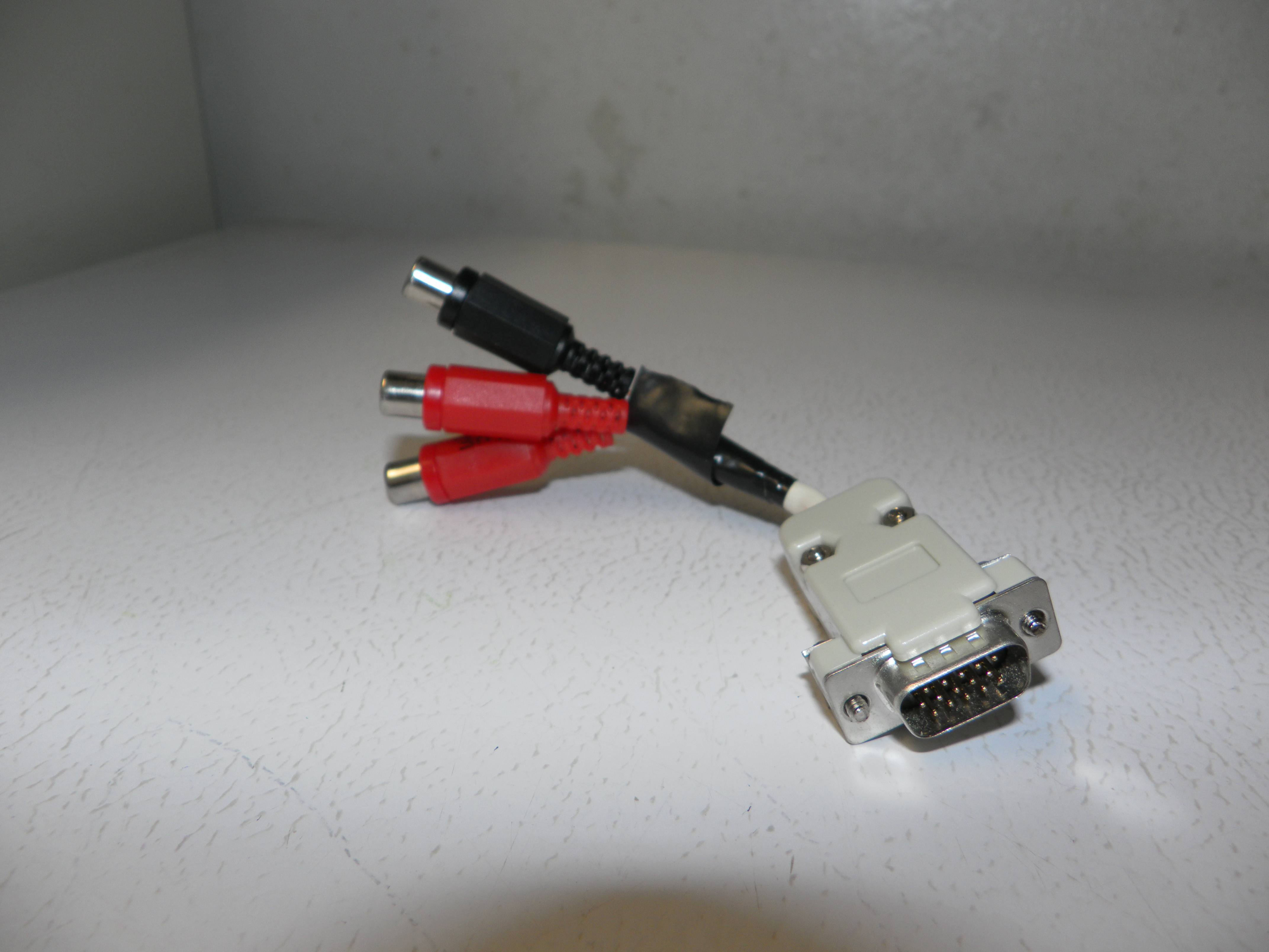

Maybe you could make one of these adaptors like I built to convert RGB to VGA.
