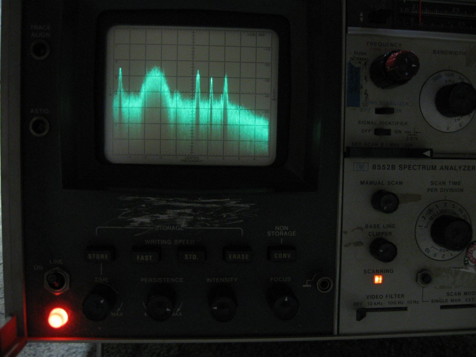

GOES E 20Mhz Span.... Centered near LRIT
This is the GOES East transponder output @ 20Mhz wide sweep.

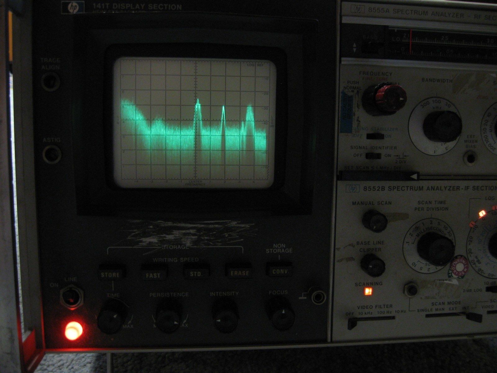

EMWIN 10 Mhz Span .....1692.7 Mhz
This is the EMWIN-N broadcast off the GOES East spacecraft.

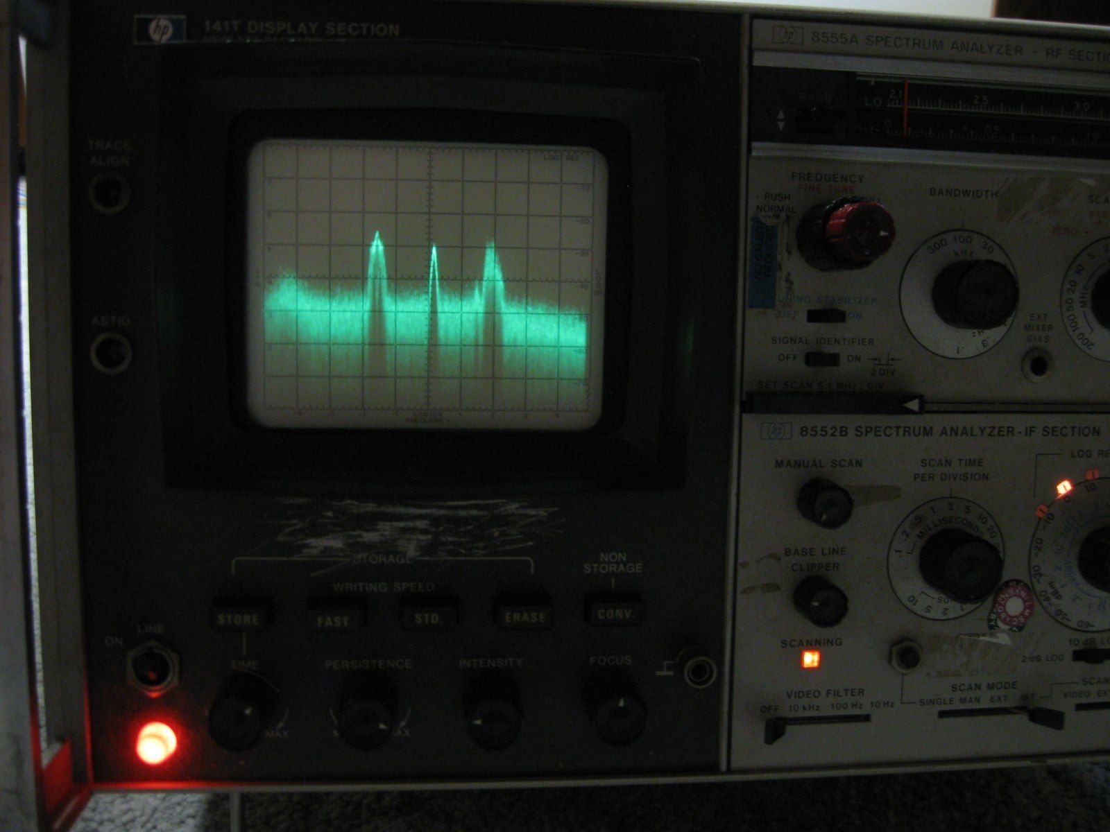

LRIT 10 Mhz Span .....1691.0 Mhz
This is the LRIT broadcast off the GOES East Spacecraft.

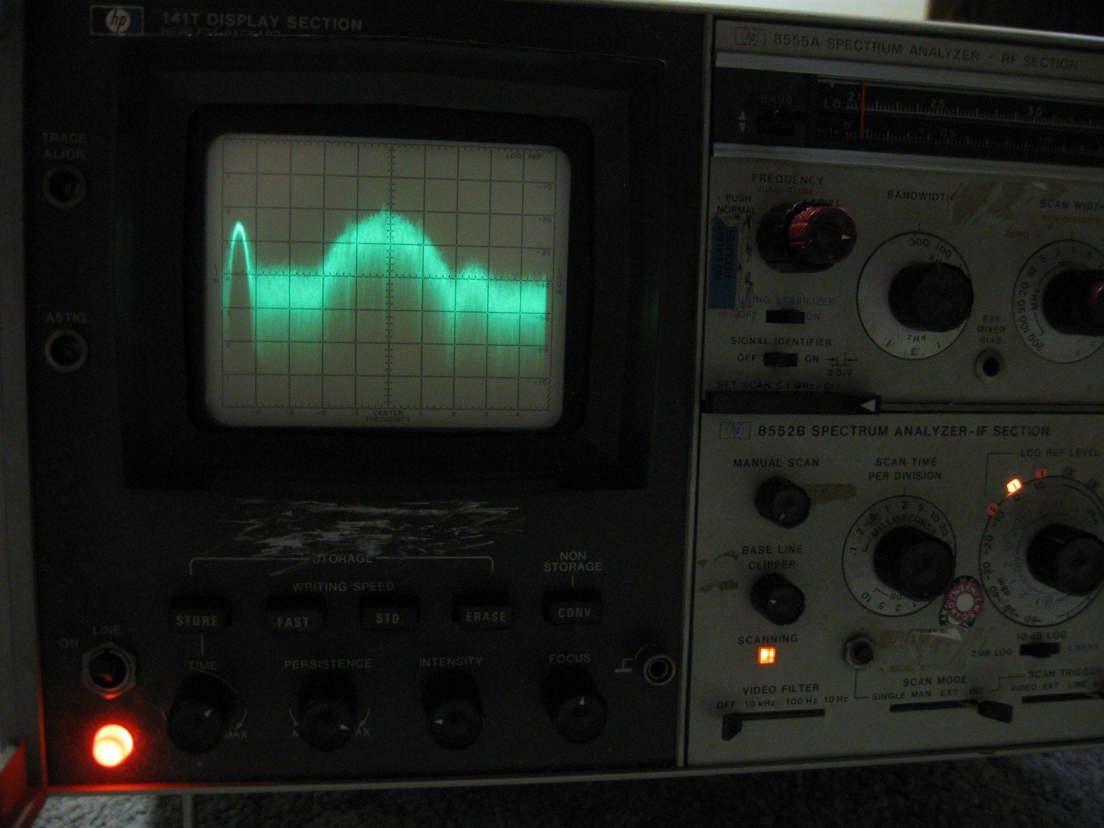

GVAR 10 Mhz Span .....1685.7 Mhz
This is the GVAR broadcast off the GOES East Spacecraft.
Note the (nobs) on top of the GVAR signal, If you can't see these clearly then you will have errors.
