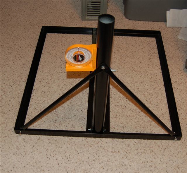

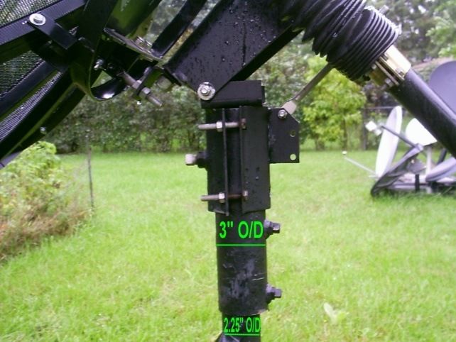

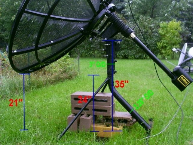

Here are the dimensions of my Non-pen mount........

I added the dimensions of my Non-Pen mount to the above post............
Will add them here also :)
