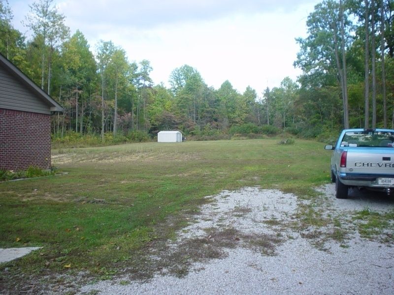

I have been researching this FTA stuff for a couple weeks now. Before I jump in any further I am wonder if I post some pictures of my location can some of you tell me if its even possible. I am completely surrounded by trees, however I have quite a bit of yard. I am condering a 31-36" dish and undecided on the STB or PC cards yet. IF it is ok I would like to post some pictures for some input.
I think everyone here likes pictures, I know I do. As far as the trees are concerned, its more a matter of how close the trees are to you and how high they are. Also, let us know where you live, if you are up north you will need to angle your dish down more than someone closer to the equator, meaning your trees will be more of a factor.
I am located about 20 minutes southwest of Indianapolis.

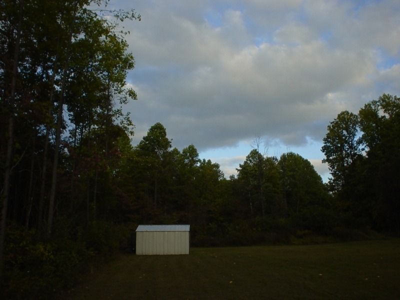

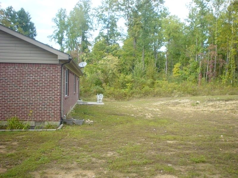

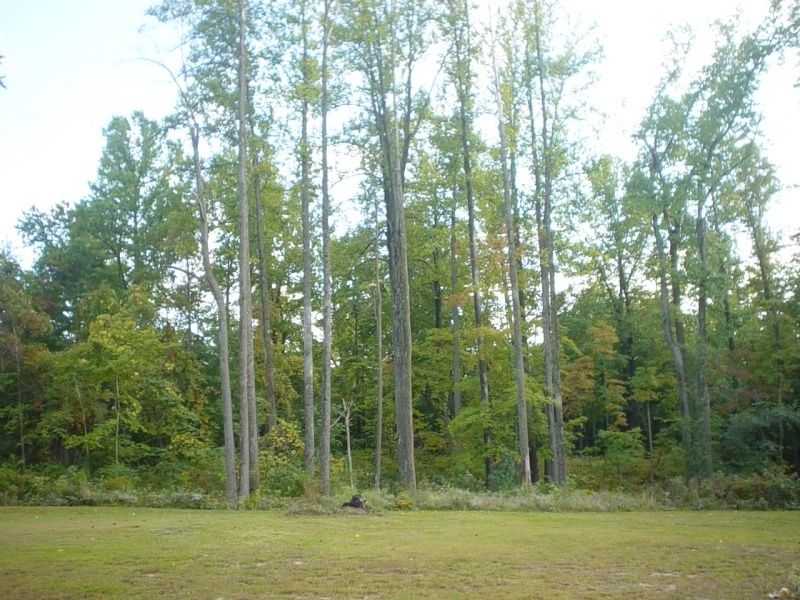

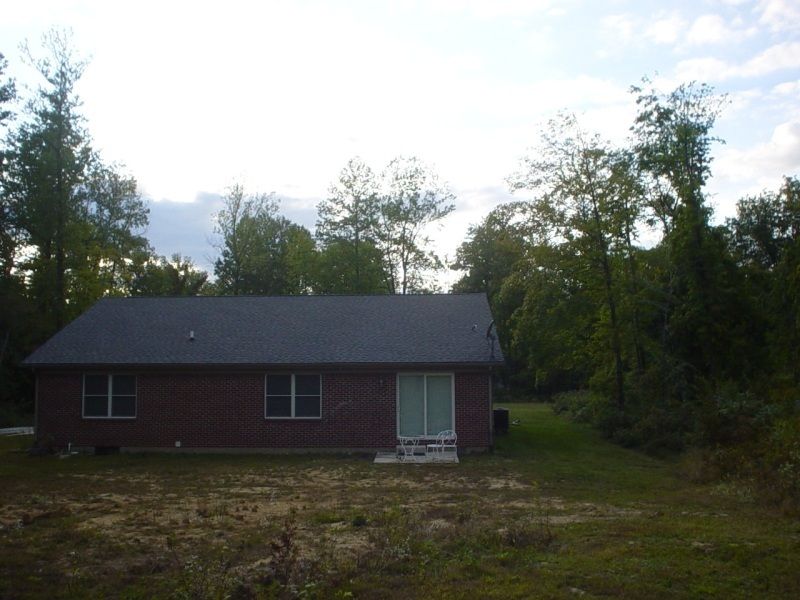

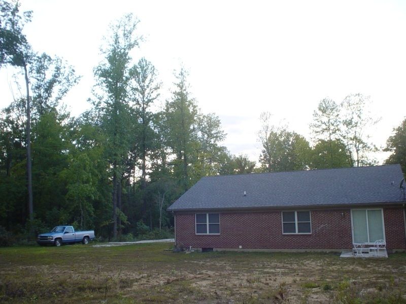

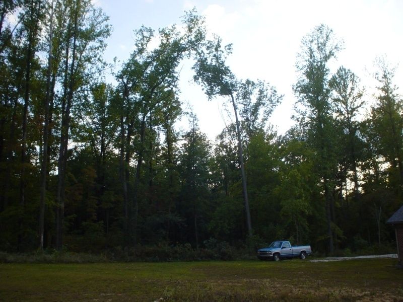

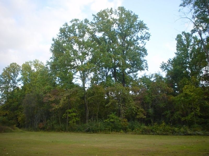

hope these give an idea of what i am faced with. I took these standing near the spot i think will give the best LOS. I am starting to worry the trees may be too tall.

Which of those pics is facing due south? From the looks of that, I'd think you could get quite a number of the sats....remember as the dish moves west from due south it will decrease in elevation, same thing as it moves east from your true south satellite. So, as it "looks" lower trees may become obstructions.

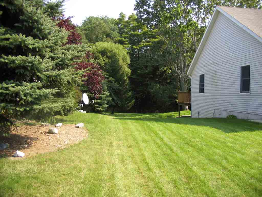

Here's my setup on the south side of my house. Notice how close the neighbor house is, but it doesn't interfere. The only LOS issue are the neighbor trees that cut me off to the east . I still can get 72W to 148W , with no problem.
the 4th picture should be direct south, possibly slightly right of it. if you go by the direcTV dish which i believe points SW across the pickup truck.
Wow, that makes me feel pretty good then. Thanks for the pic.
Putting the dish up along the eaves of the house can get you some needed elevation.
However, for a newbie, I'd recommend a short pole in the yard for getting to know your system.
And from that vantage point, use the soda straw inclinometer below, along with a PDF printout of satellite elevation, to determine which satellites you can and cannot see.
