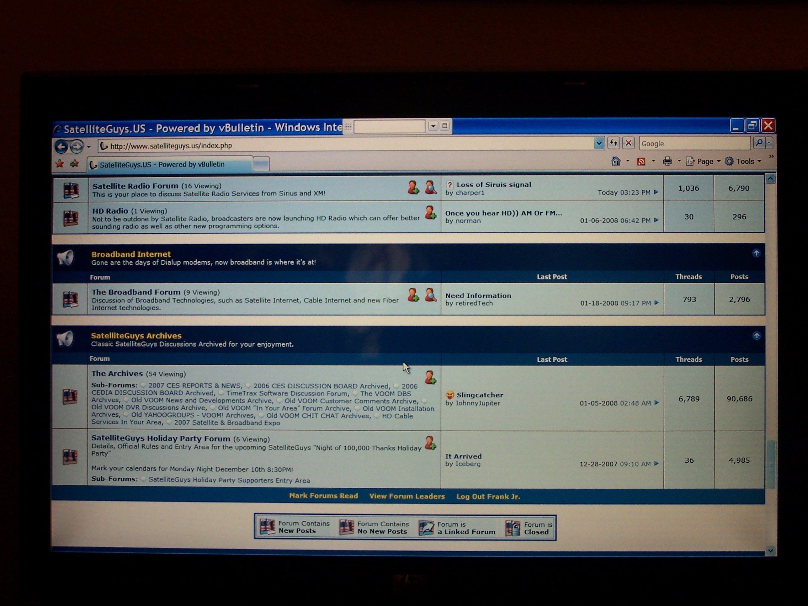

I have two opposing shaded areas on the bottom of the screen on each corner. In the attached photo the screen appears dark however it is actually quite bright. I darkened the photo so that the shaded areas are easier to see. Is this something to worry about or just normal. Other than replacing the LCD is there anything I can do?

Obtw I did take the decorative frame off thinking that the retaining frame maybe too tight and thus binding. I found it quite lose. I loosened the screws at the bottom a little more anyway however it didn't change anything. Again I want to emphasize that the screen is still very bright with plenty of adjustment room to go brighter however any brighter it would cause eye irritation.

You can see the same temporary effect when you touch the screen with your finger. The screen may not bounce back from whatever was causing the pressure as it appears to have been more sustained than a "finger touch". I wouldn't worry about that or the age of your laptop. My Dell I'm typing on is 3 years old and I just purchased another 2 year on-site warranty for it. As the old saying goes, if it ain't broke, don't fix it. IMHO though, warranties are a mandatory thing with laptops especially if you cart them around a lot like I do.
Is it possible that when you close the laptop that pressure is being put on those corners? That is the "hinge side", and if it's tight there, then the corner bezel may be putting pressure on the screen and causing that.
The LCD display is made up of many layers with a number of them at the back for reflecting the light through the display. The display is lit up from a flourescent tube in the bottom (in this case) of the display. The flourescent tube can burn at the ends causing the brightness to be uneven in the bottom corners. Also, if the reflective layers become warped or creased the image will have dark and bright spots. This is more common in seeing spots in the center of the display due to the notebook being put in bags with books or other items pressing on the cover damaging the internal reflector. In your case it could be from the hinges as mentions by another member in another post or the tube burning at the ends. The tube is just like a small version of a standard flourescent tube. They blacken up at the ends as they burn out. The tubes can be purchased and replaced, but the job is very difficult and can cause more damage if not done properly. Most repair places will onlt change the complete LCD panel and not attempt to change the tube itself. The display can continue working for a long time before the flourescent tube will no longer light up.
