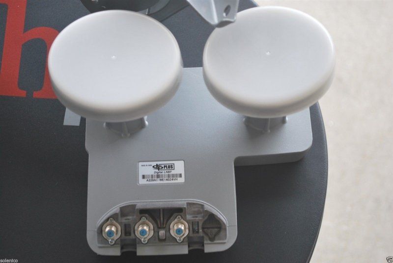

I have the 1000.2 Eastern Arc 2-head LNB like the one in the picture. Right now, it's powering a solo receiver for me and also one for my neighbor. I notice that there is a 3rd lead on there. Can I put a third solo receiver on that if I run another coax line?
With the addition of switches you can add many receivers.
If I put a switch on it I wouldn't have to run another line? Which switch should I get?
I'm pretty sure you could have 3 dual receivers, not just 3 solo receivers.
That's an EA LNB so 2 wires from it to a DPP44 will get you four receivers, chain another DPP44 for 4 more up to 3 DPP44's for 12 receivers. There are ways to get more than that if you need to. :)
