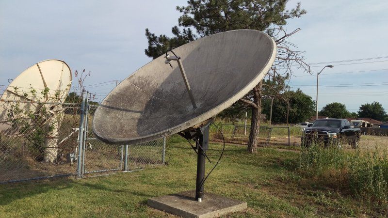

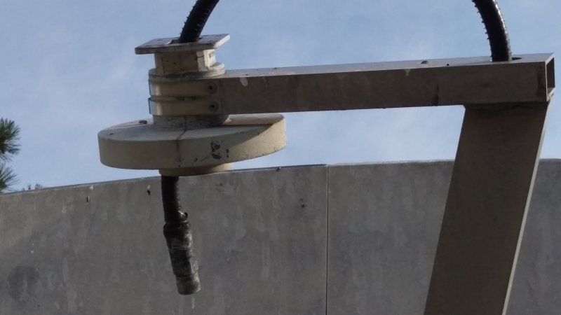

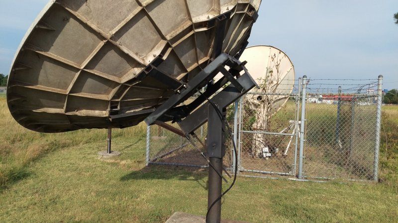

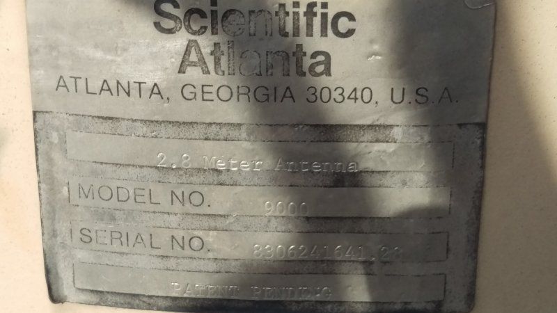

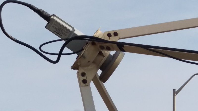

As requested, here are the photos. One of them is a Scientific Atlanta satellite with a really nice base. Cant find any info on the other dish and it is fiberglass, just as large but not as fancy. Both are about 8 feet in diameter.
All this is new to me, having just recently set up a Ku Band system. I am not impressed with the programming I receive on Ku Band, so please assure me that switching to C Band will get me something worthwhile? :)
Question: Based upon what you see here and assuming I do all of the work myself, how much do you all think it would cost me to set up a C-Band FTA system (dish motor, receiver, LNB, wiring, etc.). I don't own any C band stuff right now other than these (compatible?) dishes. Thanks.

Hello, thanks for the pictures it helps very much.
The dishes looks great, and they are an excellent add on for your satellite dish line up, Scientific Atlanta is very well known brand for making excellent satellite dishes.
Also soon I will be doing a first BUD install, but I can relate my experience from having done some field job on FTA mesh dishes in the past.
The required accessories would be:
- An C-Band LNB ( a fellow forum board member can recommend the best one, there a several brands )
- 75 Ohms cable, you would need to measure the amount of length required ( can be at any electronics store)
- An C-Band FTA receiver, perhaps there can be fellow members that can recommend a receiver, I know that there are FTA receivers that has a DVR
build in as well, that you can program to record your favorite program automatically.
- I do see that the dishes pictured, has an manual inclination and declination mechanism, not sure if an actuator would work on these dishes.
There is an website called www.lyngsat.com where you can see all the line up of the channels on the different transponders, lyingsat is not always up to date but it is is updated regularly.

Both of those dishes are on fixed mounts. They cannot be motorized. :( However you can do a multi-lnbf setup. I would go for sats at 97W, 99W, 101W, 103W,. put two LNBFs on each dish. One would have 97W and 101W, the other with 99W and 103W. This would give you a very nice selection of C-Band channels.

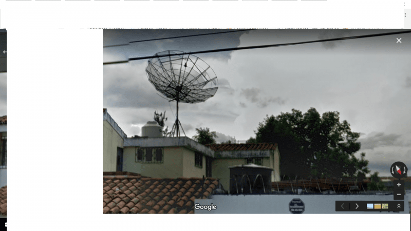

Sin ttulo

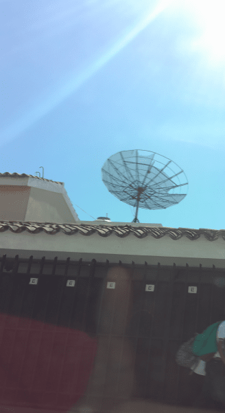

Look what I found 1 km from my house in the traffic, what brand will be , believe that you can easily repair the maya
what measure do you think it is
I'll ask if they sell it
I hope if for little money, and does not end in the scrap
Captura de pantalla 23
B
Brct203
Dec 24, 2016
1,294
1,310
Connecticut
Looks quite large... at least 12 feet, maybe 16 feet (4.80m)? I'm not sure about the brand...

Looks to me the first dish is on a polarmount but in a fix position by the four welded bars .

No sure if this has been addressed yet, forgive any repeating.
The "Scientific Atlanta," was marketed for radio stations, and usually installed back in the 1980's to receive 139W in fixed position. Unique in mount, unique in how it's polarity was chosen for the LNB. The mount is MASSIVE, and usually sat on about a 4 x 4 by at LEAST a 4' pad for stability. Many stations still use these, in fact WE do, but now it's aimed like most other stations, at 105. I can't speak to it's 2 degree compliance, but the engineering is amazing. There's a rod that comes down through one LNB support strut that turns with a screwdriver to run gears which flip the LNB from one polarity to another. With some engineering you could put a modern LNB on it, and as others have said, a "fixed" dish is great for 99w, 101w, 103 w, any C-band bird with enough open feeds to add to your viewing experience. You will, however have more engineering to reinstall
this model than in a standard "pole mount." The Scientific Atlanta units are VERY stable, and have multiple lockdowns for horizontal and vertical position so you won't be drifting, that's for sure! They'e very HEAVY but can be disassembled...plan on quite the project. Given your situation, not probably suited to your intended use, however...for SOMEONE...not a bad thing for a "fixed" install that will last probably forever with almost no maintaining, except maybe some painting now and then, and some treatment to nuts and bolts on the mechanisms. Pictures attached of our re-aiming this year for network radio..
