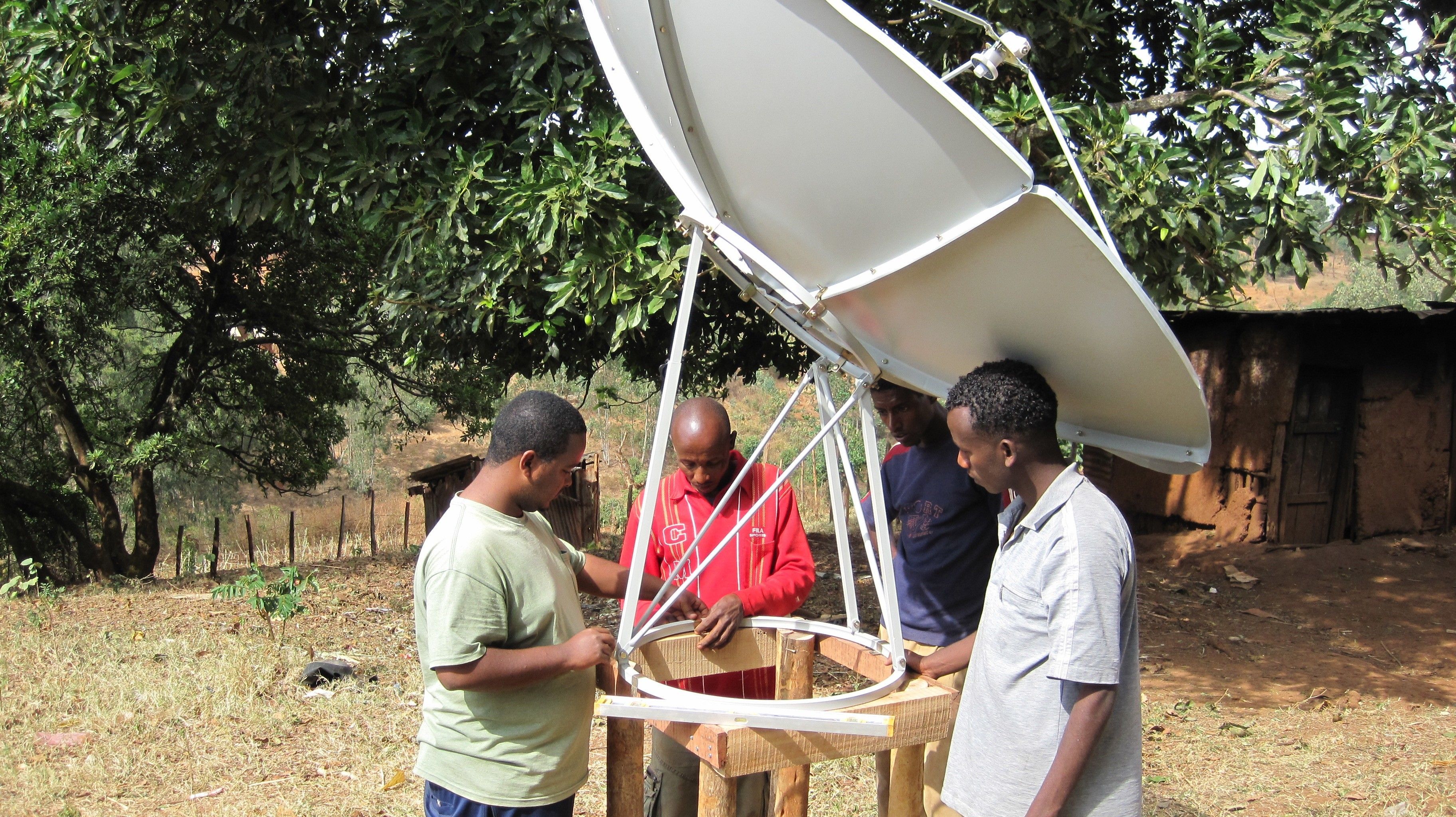

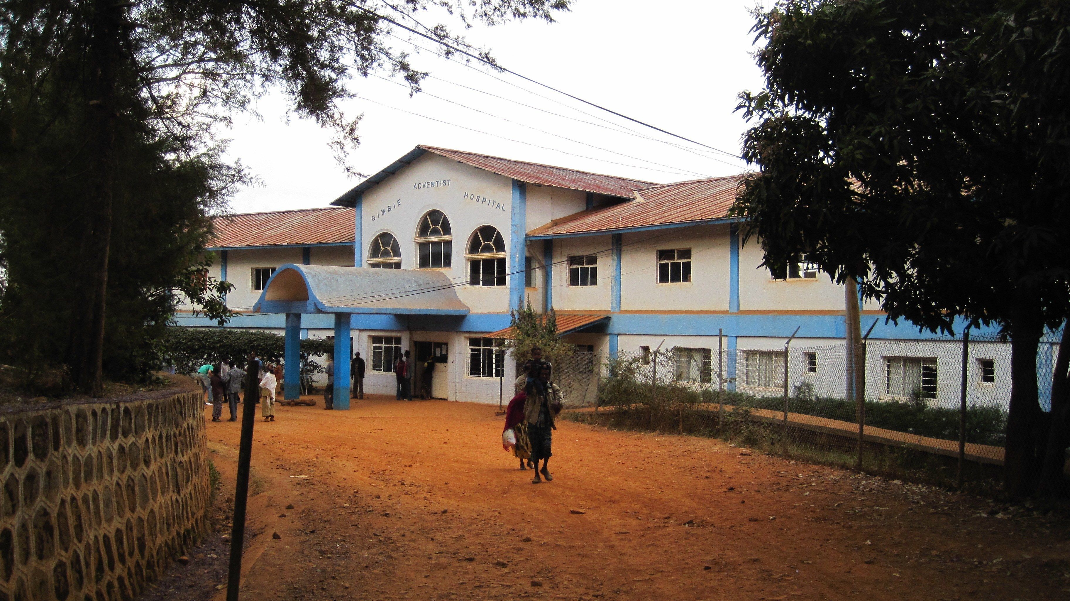

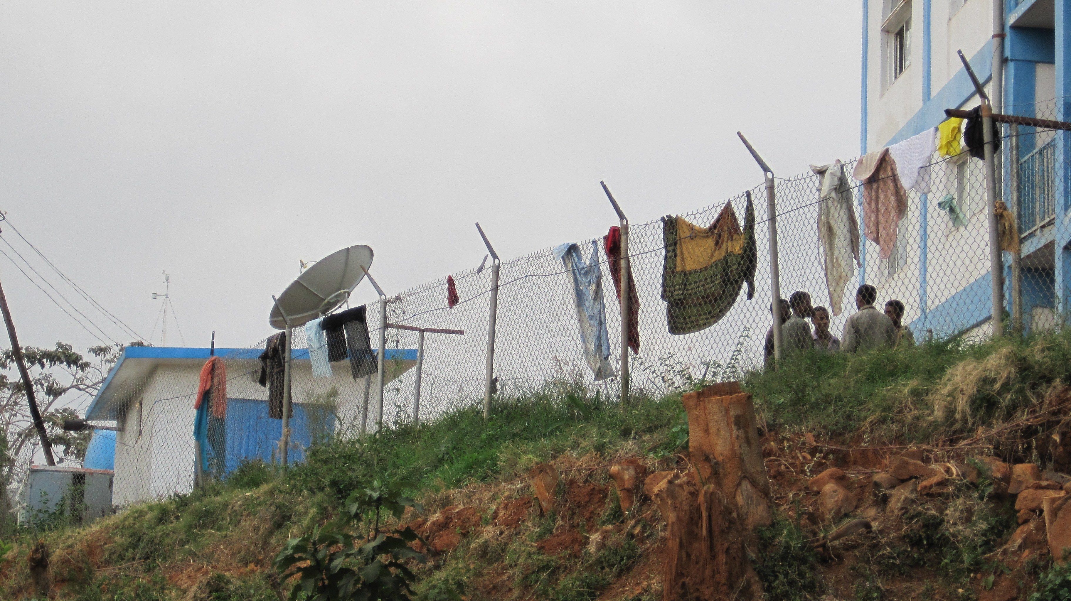

Well I am back, Taught a local Ethiopian how to install, so mission accomplished! I learned probably as much as I taught. First rule in Ethiopia is NO rules. So when you buy a dish and an LNB from a retailer - don't expect that they will sell you a matched set. An Ethiopian man was sent a week in advance to purchase the dishes, LNBs, receivers and cabling. When I arrived in Adis I wanted to see what he had purchased - too late already on the truck under a huge load of other things (see picture below). It was an 11 hour trip to Gimbie where I was to do the installs. Upon arrival I found the dishes to be 1.8 meter (6 foot) prime focus with a F/D of 0.35 and LNBs for offset dishes with a F/D of 0.7. We were able to find some Prime Focus LNBs locally! So that solved most of that problem with the exception of the Hospital that needed a dual feed LNB - so we used a mismatched 0.7 twin feed LNB with two runs of over 300' used a 13db gain amplifier on each feed. Had hoped for two channels but settled on one and called it a win. We didn't have time to pour concrete and allow it setup and come up to strength. So two of the dishes were set on wooden poled decks until concrete can be poured later. The hospital had a nice flat concrete roof over the generator building. We stayed in an unfinished "Hotel" no hot water (only cold showers), no running water in the sink, concrete floors, no mirror (I didn't bring one) and of course a hard mat to sleep on (no mattress). You will note the picture of a tanker truck hauling goats on top for extra revenue for the driver! Had a great trip and a great teaching/learning experience.:angel:
