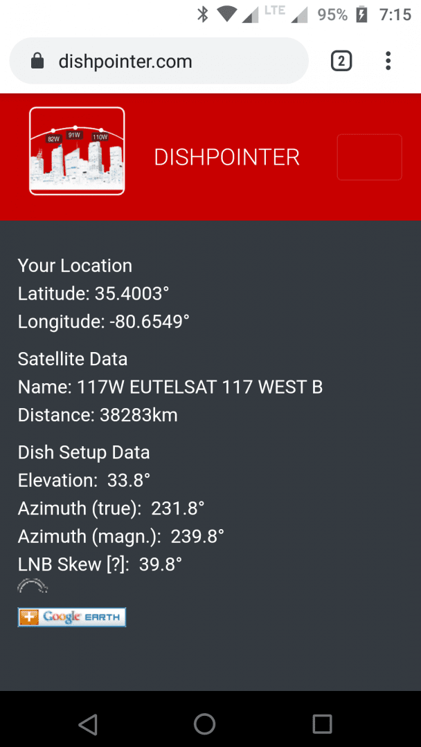

Can anyone explain how to get the offset angle for the Orby 117W. I got the Elevation & Azimuth from Dish Pointer.com, but it didn't list the offset angle. My Zip code is 28027 in North Carolina. I am converting a DTV slimline dish. Thanks in advance for your help..

Of course, dishpointer.com can not list an offset angle of your dish, as they do not know what kind of dish you have. Why do you need to know offset angle, may I ask?
I might be confusing the offset with skew. I guess I mean skew setting....
Dishpointer shows a Skew of 39.8 for the zip you listed..I played with the Skew on my Orby dish and it didn't make any difference on either transponder where it was set at...

Remember though, if you're using a DIRECTV Slimline mount the skew or "tilt" setting on the back plate is numbered to be 90° minus the skew number from dishpointer.
So you would set the skew on the dish back plate for 90°- 39.8° or approx. 50°.

I used a fta dish that uses LNB skew with the dish staying fixed - no dish skew so it's easy to fine tune the LNB skew and found it did make a difference. Dishnetwork has a strong circular satellite close by at 119W so spending a little extra time to peak the skew should help keep interference at bay.
