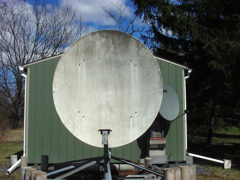

We put up the Prodelin dish over the weekend and I ran into something I never thought about before. On typical prime focus C band LNB housings, the feed end is normally pointed somewhat downward. Offset dishes have the LNBF pointed in the upward direction.
Is there a C band LNBF the doesn't have the small holes in it? I plan on putting my spare BSC621 on for now,but I fear it might collect water when pointed up at 30 something deg. Sadoun has the B1SAT C band LNBF which looks appealing if it's sealed like a Ku LNBF. Does anyone know of a sealed unit for offset applications?
Here's what it looks like so far.
The dish behind it is pointed at X4. I'm glad I never made that permanent.

my prodelin c band
I had a 6' prodelin up for a while. I used two C-band offset astrotel lnbf's.
The lnbf' would actually work for prime focus but they came with offset scalar rings that looked like a funnel with a cheap plastic cap over them.
I bought mine about 4 years ago from American Satellite Distributors for DirecTV, Free-To-Air, Satellite Dishes, Towers
Jay had them then. I don't know about now.
That looks exactly like the prodelin I had.
That prodelin is heavy isn't it.
That's an interesting website, I never heard of it before. Thanks for the info.
Yes that dish is heavy! The setup is rock solid and won't be going anywhere. I still can't believe how nice it's made. This commercial equipment is my favorite. Hopefully tonight I'll have some time to try for some pointing.
I think some of my upcoming free time will be fabricating a conical scalar ring with this setup. I'll keep everyone posted. :)
