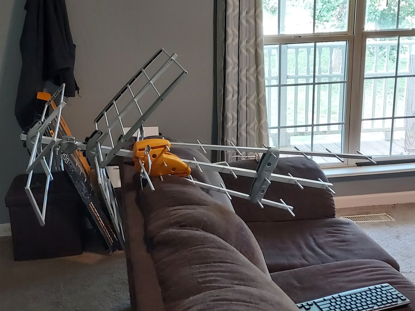

It's here! Got most of it together in 10 minutes, then ran into a snag. Lower reflector snapped right in can not it the upper reflector in. Swapped brackets with the Vhf set and still will not go in. Got frustrated and will try again in the AM since it is raining anyway.
You sure the reflectors aren't flipped upside down the wrong way? There's a bottom and a top...
Yep, tried both ways and even moved the brackets. It wont seat all the way down into the indent, thinking I will need to take a mm or two off the reflector. It is close, but no cigar.
should say of the bracket, will look at it tomorrow and see whats up. So close yet so far and yes watched the video, paused it made sure it was right. Just a little too tight somewhere. It does not help that it is dark in here, that is why I will deal with it tomorrow.
The VHF element snaps right in with either brackets, seems like the boom ot the reflector is just a millimeter or two to long.
No need to, thought about it and exactly what you said, the boom had a little bump on it. A coulpe of light taps with a brass hammer and it is assembled. Thanks Mike. Actually like I said. Turns out there was a little hump in the boom.
Reactions: primestar31
This my friends is why when you get frustrated walk away for a few minutes and try again. Should have known right away because I could not slide the pole mount down the boom, had to separate it and then get it in the middle and reattach it.
My completed indoor installation
