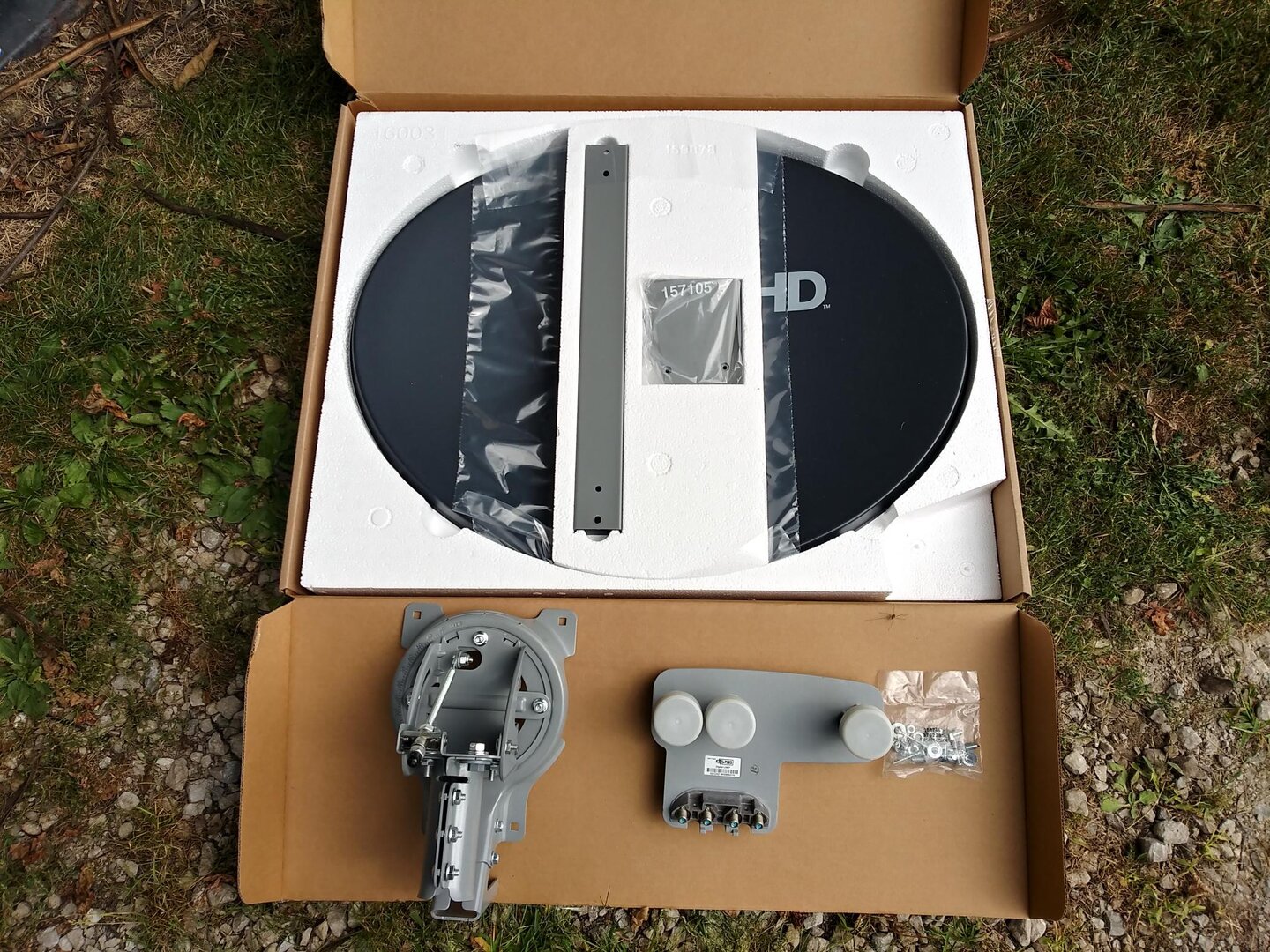

So got it setup on my temp pole, wow the fine tuning on the 1000.4 sure makes things easier. Fiest did a check switch with nothing connected to clear memory. Then locked onto 72 with a good signal and did a check switch and got all 3 east sats. Played with the elevation and azimuth with the fine tuning to max out then adjusted the skew a little and helped more. Locked things down and will do a permanent install soon, rain coming in now.....

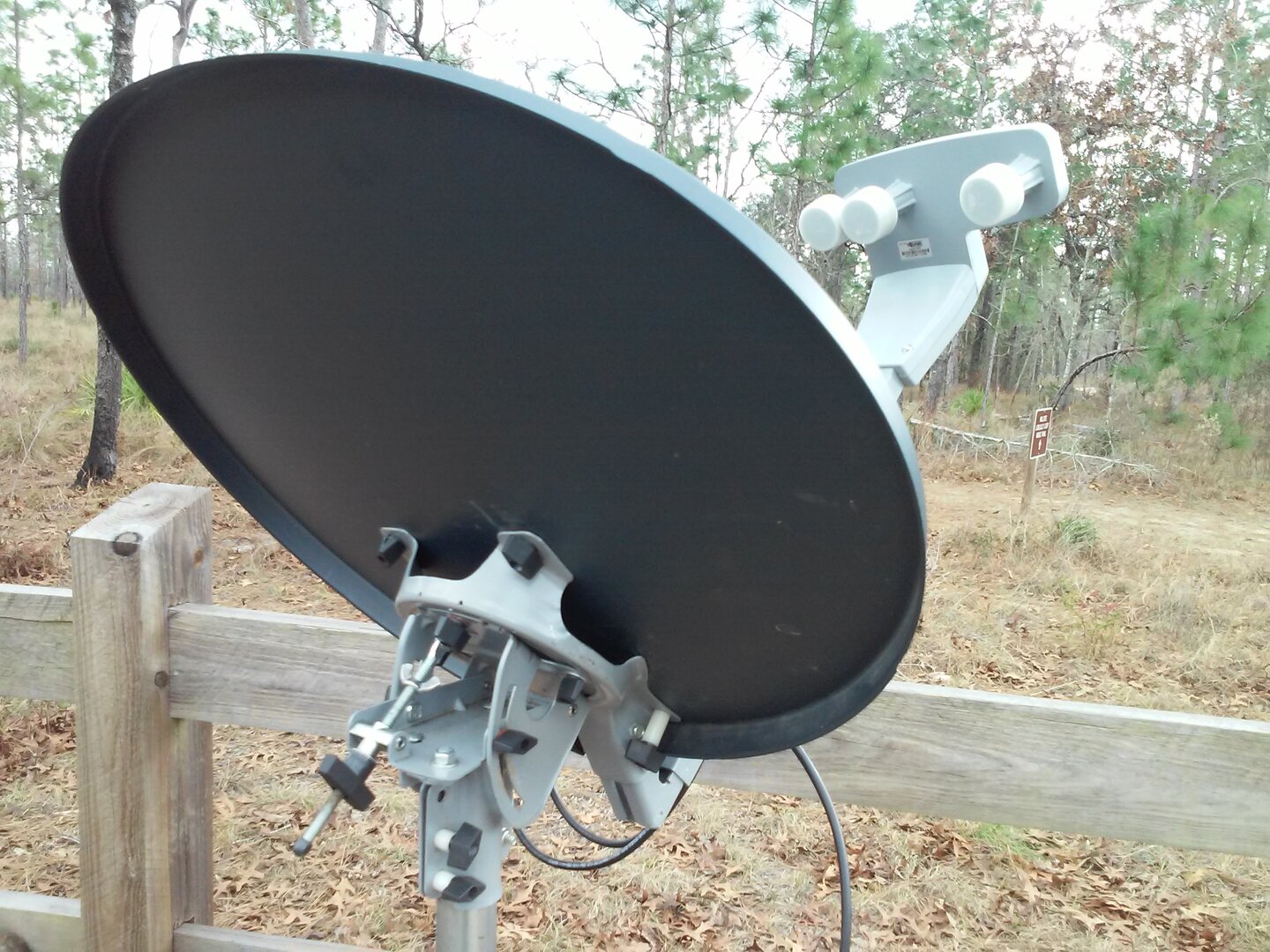

Yes, and it's a really nice design for RV'ers like us that set up and dial in the dish as often as daily. I modified mine for a no tools needed setup.
Oh, is that the kit from TV4RV that has the foldable arm and knobs? It's pretty neat for $50, lets me store my tripod in my pickup truck or garage while using like half of the space.
No, I either remove the reflector for travel so no arm folding is needed, or stow the whole unit in back of our SUV that we tow behind us. As you can see in the photo, the reflector bolts are also equipped with large wingnuts. The spacers I used where needed are just nylon bushings that I bought along with the plastic handled wingnuts at an Ace Hardware store. I'm aware of the TV4RV kit, but the arm folding mechanism is so simple that I would have just duplicated it with common hardware if that would have worked better for me than popping the reflector off as needed.

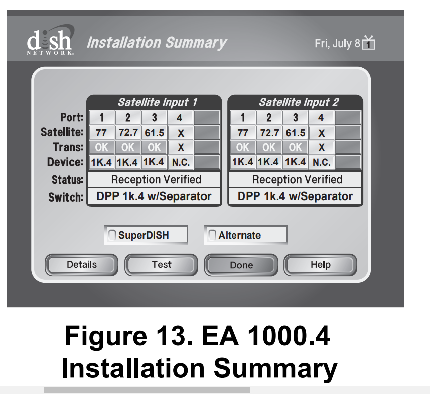

Instead, can you post a picture of the switch info screen? You can tell if the sats are coming in the correct LNBF's from there, the screenshot below is from the 1000.4 manual, so if everything is as you say I would expect it to be something like Conn.--72.7--61.5 on each respective port
Well when I first setup on my permanent pole I put foil over the outer LNB's and locked on 72.2 so I figured it was on the correct LNB's.
OMG, you actually followed the instructions! Congratulations. Yes, you have the right sats going into the right LNBFs. I am guessing you won't have trouble with your receiver trying to tune channels off 77. I suppose you could regain reception in the fall...

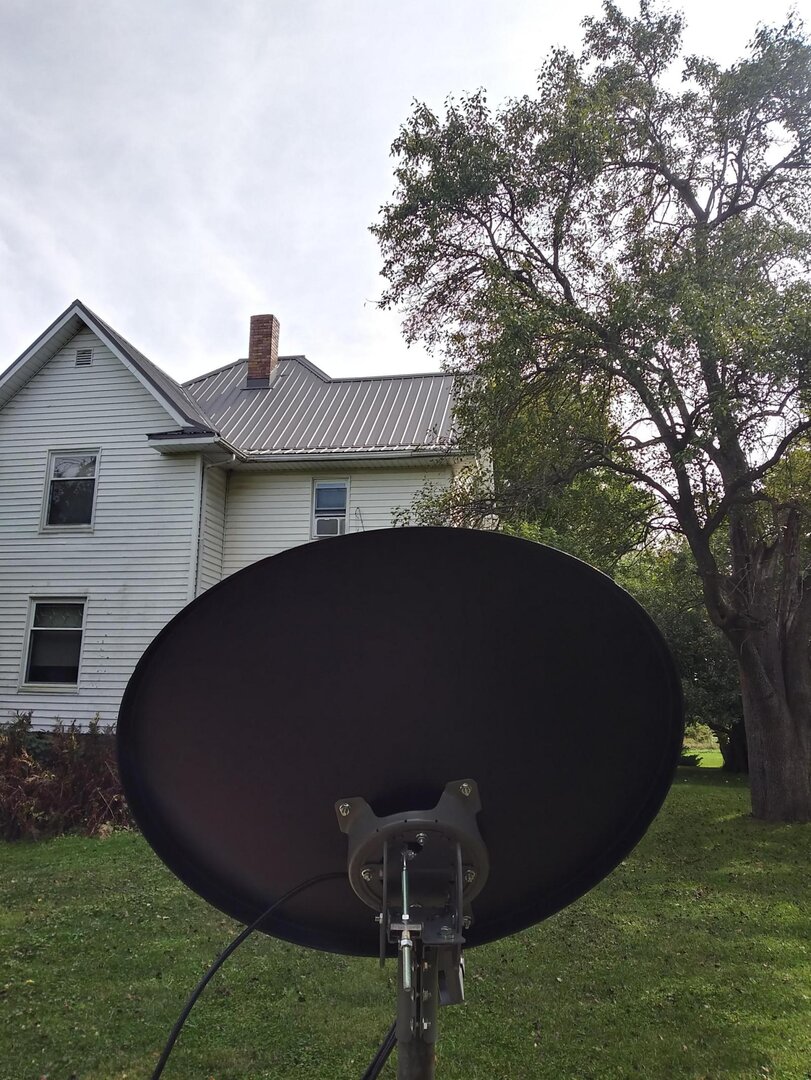

Well here's a pic from behind my 1000.4 showing why I am prolly not getting 77. So I either move my permanent pole or take down a tree for either the west or east feeds...come on man. Pretty sure I had figured the east sats were a little more to the left.....
