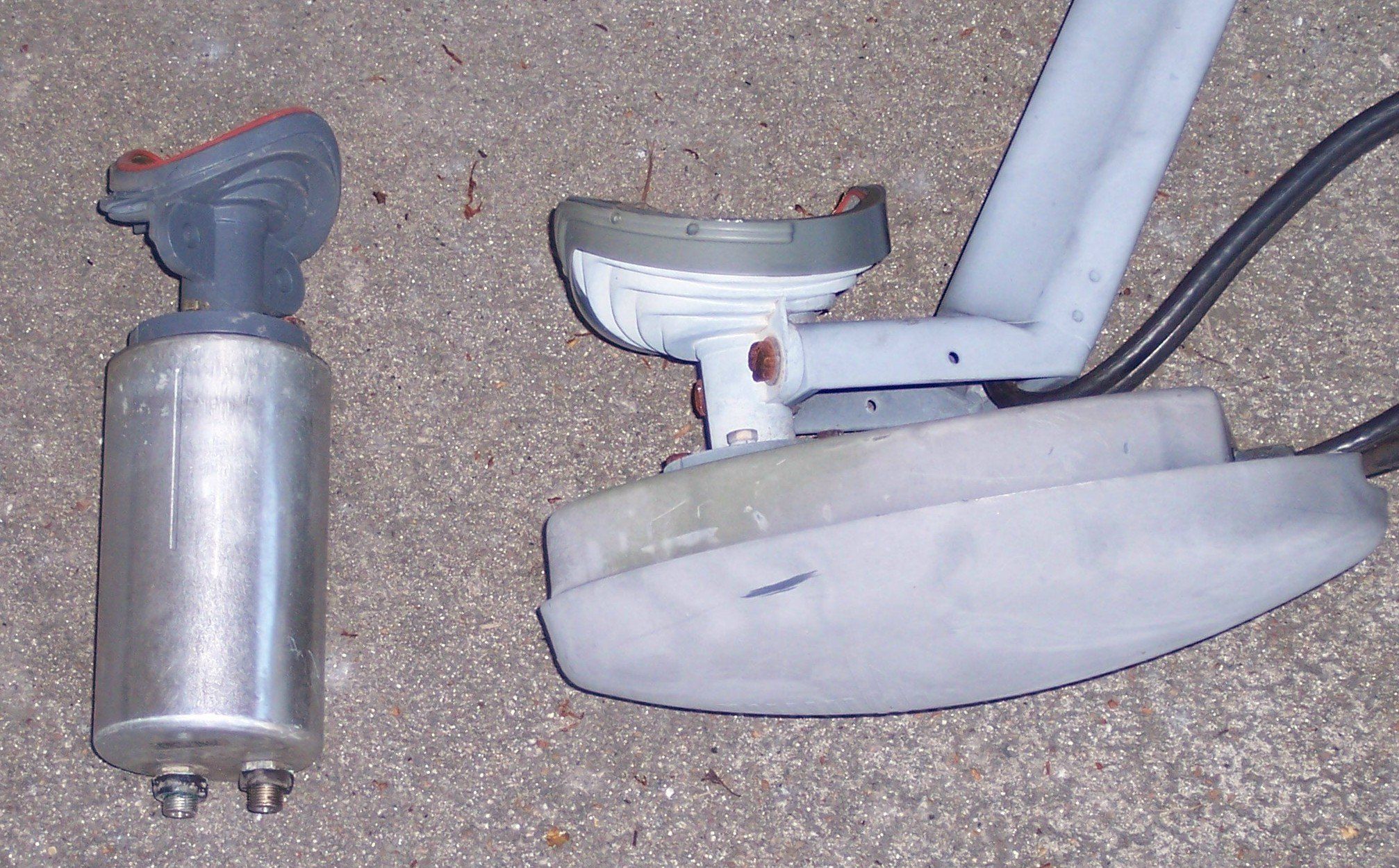

I have a very old Primestar dish ( not round) approx. 40" wide and 30" tall, if I but a new LNB on it should it work to pull in G18.
It has 2 coax outputs but doesn't look like either of the pictures. It is l shaped with a plastic cover over the front slightly smaller than a dinner plate.
thats it. what would you recommend for a replacement?
My recommendation: DON'T REPLACE IT! if it works.
You should get a 2x4/3x4 multiswitch instead to recombine the Horizontal and Vertical coax outputs together for ease of use with FTA receivers.

I believe the H & V outputs are marked, and you can tell which is which if you pull off the cover. When you attempt to test it make sure you are connected to the correct polarity output for whatever transponder you are trying to lock.
From what I have read here the performance of that stock LNBF is more than satisfactory on that dish, you can probably pay for a multiswitch for about the same money a new LNBF would cost you.
