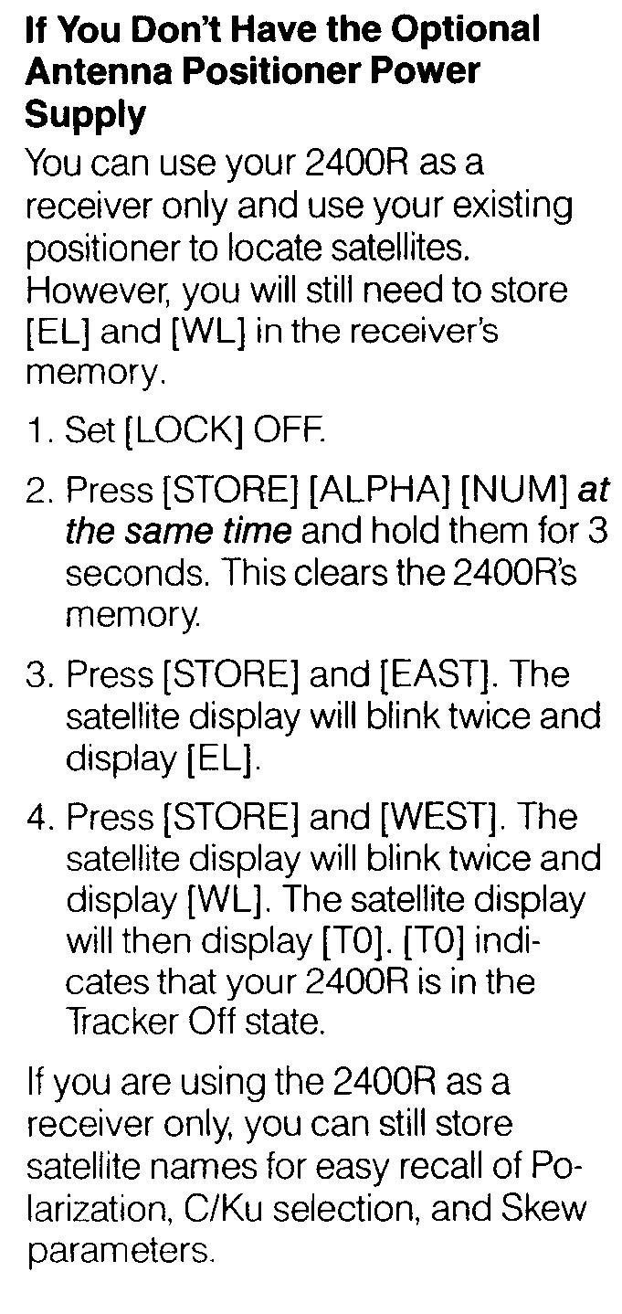

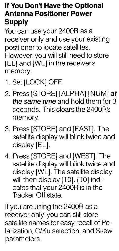

master reset is
set [LOCK] off (three seconds )
press the [ALPHA], [NUM] & [STORE] keys at same time and hold for three seconds
the memory will be cleared
master reset is
It Worked! Thank you for that vital information.
I should have read the manual closer:
[TO] means that the motor is turned off...
