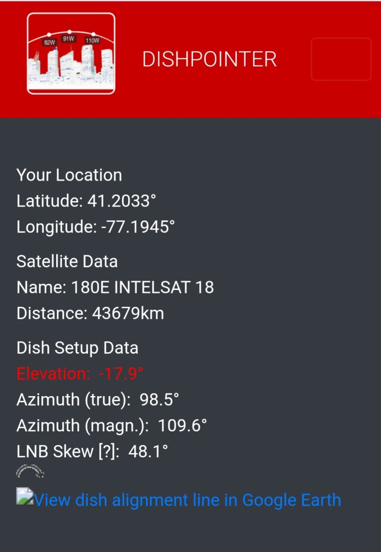

Ok I put in the actual position I will be in and got the attached.....
