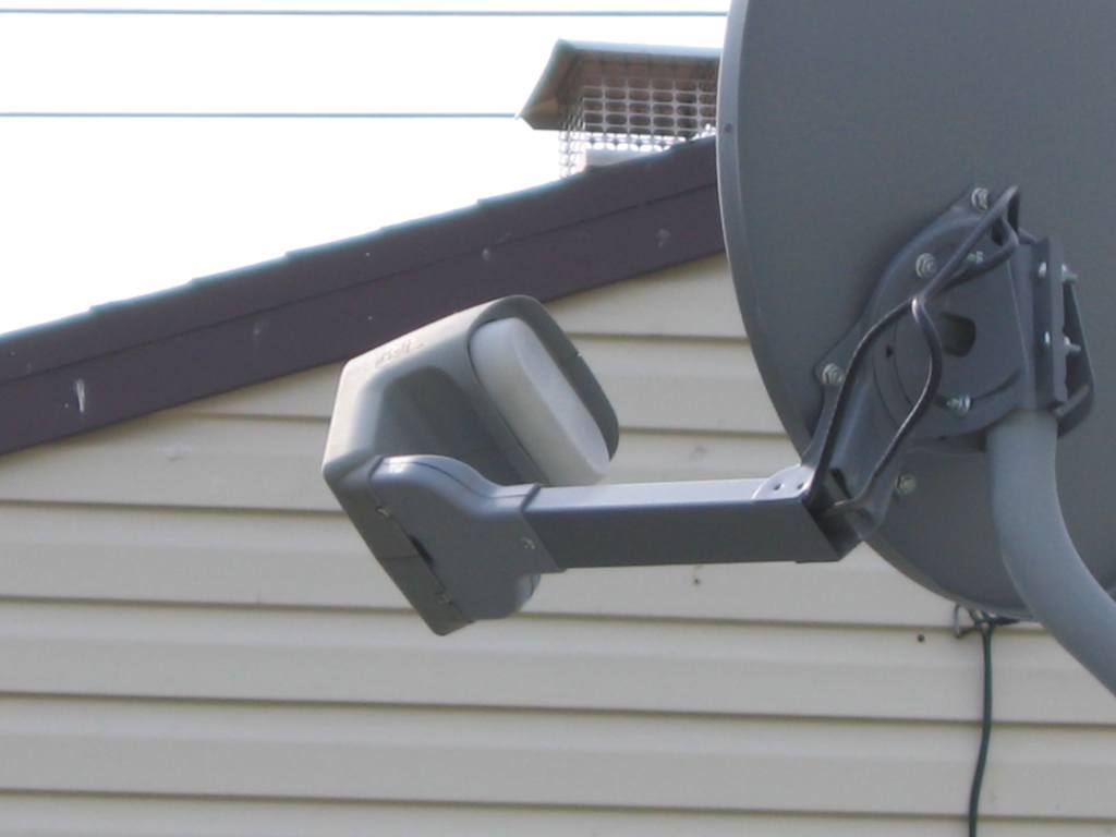

Right now I have Dish 500 with two receivers. I want to add another two receivers, but i'd rather not put another dish on the roof, so I was looking at LNB's with four outputs on them. Do they make LNB's that have four outputs on them & can pick up channels from both the 110° and 119° satellites? I attached a picture of my dish as it is currently.
Thanks in advance!

You need to tell us what receivers you have and plan to add and if that LNB is a DP Twin or a Legacy Twin. You can look in the front of it and it will say DP.
You have two options depending on your receivers and that LNB. If all of your receivers are DP, you can use a DP Quad LNB. Then you will run 4 cables from the LNB to the receivers.
Or if that LNB is also a DP Twin then you can use a DP34 switch. You run 2 cables to the DP34 switch and from there to your 4 receivers.
One receiver is a 2700 and the other is a 3700. My parents got Dish back in the summer of either 1998 or 1999, and recently the dish itself was upgraded to the Dish 500. If it matters, both of the receivers have the new yellow smart cards.
When you say the 'front' of the LNB, is that the part facing the dish, or facing away from the dish?
crap...you'll need a Legacy Quad
DishPro won't work with those units (unless you get an adapter)
Quads are pretty cheap on Ebay
