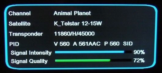

Hello Everyone!!Is there anyone with access to Telstar 12 15W using a Openbox S10?? For some kind of reason my S10 will not see frequencies with 45000 SRs. All other Tps there are fine. I want to know if this is a firmware or a hardware problem . If someone is able to do it I'm looking to get the firmware version to update mine. Thanks!!

When last tried maybe several months ago, I received the encrypted SR 45000 tp on Telstar 12 using my S9. In fact, those were the strongest tp on that satellite. My microHD receives zero RF signal from these when I last tried (http://www.satelliteguys.us/threads/308296-Trouble-Receiving-High-SR?highlight=45000). Maybe I will pull out my S9 and try again, though it seems I have some obstruction to this satellite now from tree leaves.

In my Openbox S9, I have installed C2HS2-11-12-13:0481CMT firmware. Distribution for this firmware was called DEEP_C2DS2_CMT_1112130641.
The 45000 TPs worked on my S9 the last time I tried it also. I've never owned an S10 though.
I know this thread is old, but thought I would add my SR 45000 experience for any trying to receive tps with these high SR. To receive SR 45000 on my S9 requires a "technique". First you scan in a series of channels with SR 45000. In my case, if I simply select an individual channel, the screen will be black and signal quality zero. So I start changing channels watching the signal quality reading. You can change up and down as you select the channels if you only have a couple or a few channels. Eventually, you will see the signal quality reading suddenly jump up. That's when you can quickly select any SR 45000 channel if it's ITC and you will be able to view it. It seems the transition between SR 45000 channels is what allows my S9 to be able to lock onto them. I don't know if this is normal for an S9 or a peculiarity. Once you are viewing an SR 45000 channel, it will continue to be viewable until you change channels. But this always works and allows me to view any SR 45000 channel (eventually).
