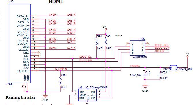

possibly a bad solder connection on the connector to mainboard.
The demo board schematic shows the connector pins.

I did check all the settings SatelliteAV. I thought maybe that infamous Format button was accidentally pushed but the super glue was still holding it.
I also haven't kept up on the issues with the Openbox but it sounds like this might be an issue.
I'm not highly skilled in electronics but given the circumstances, I don't have much to loose by trying to fix it. Tomorrow, I,ll take it apart and check those pins and connections.

Well, I took the cover off and looked at some connections and all looks good. Put it all back together and hoped it would work but still doesn't.
