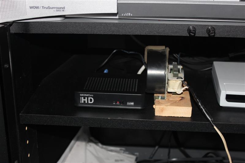

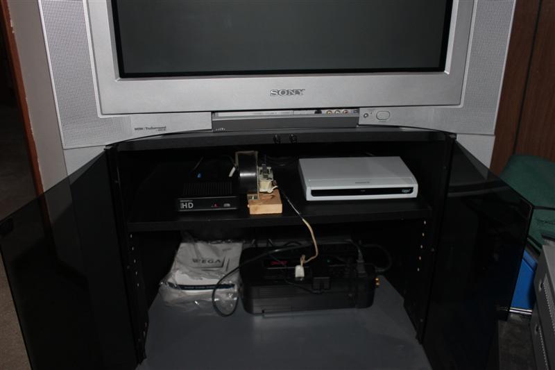

Have a really small squirrel-cage fan sitting next to the micro-HD, it blows toward the back of the cabinet where there is a large opening for the cables. This creates enough turbulence and air turnover that the cabinet stays quite cool and the micro HD (and ATSC receiver next to it) stay cooler. The fan is very quiet, when the doors are closed you can't hear it. Before after a couple of hours the Micro was quite warm on top. Now it barely warmer than the shelf and other surroundings.
Think I am going to find a longer AC cable for the fan, it looks kind of ugly running in front as it is... Note the UPS below. (Don't note the dust though...) :|
