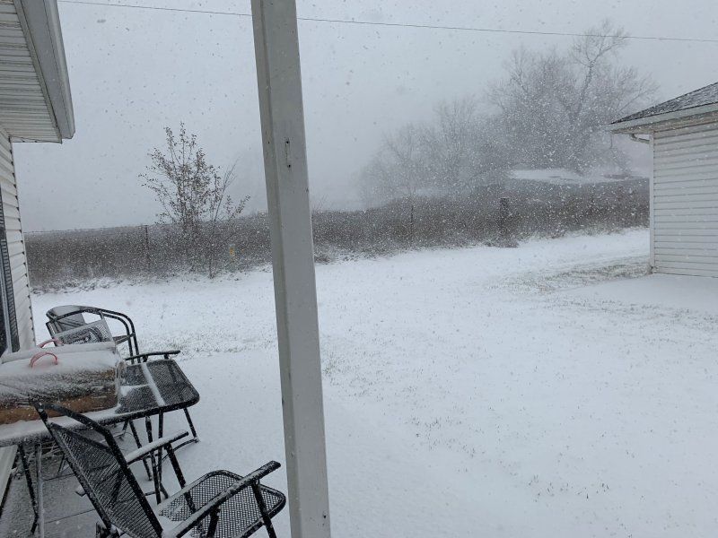

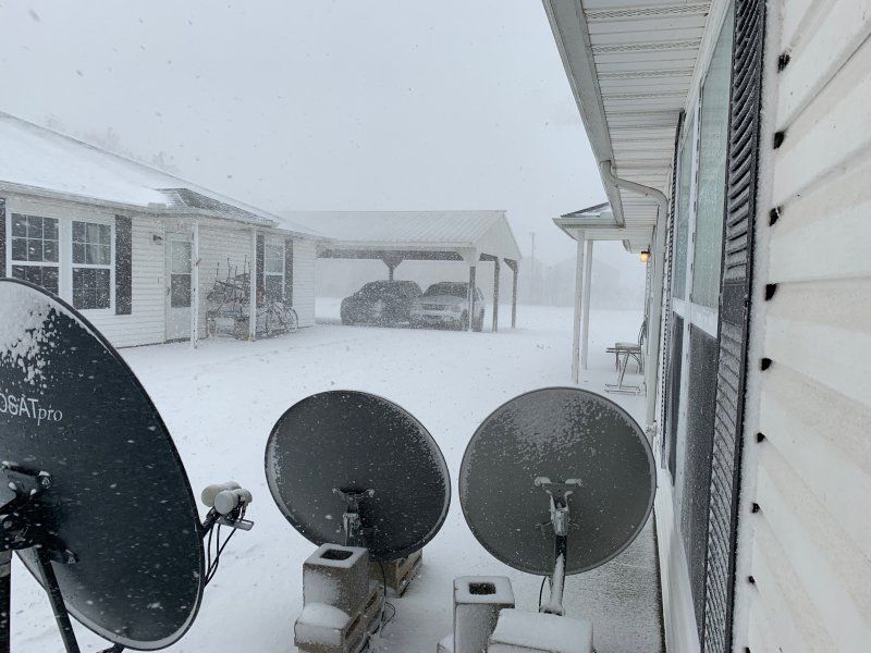

We are in the middle of the biggest blizzard the Kansas City region has seen in many years. My 90cm GSP dish is going strong! Little to no snow fade here.
