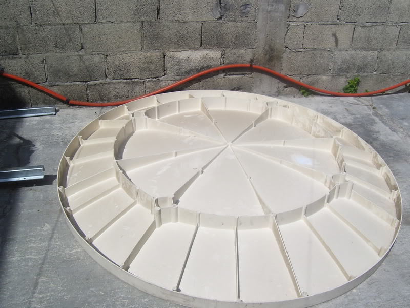

Hi, the dishes are from a sportbook of Nogales Mx, they was aimed to intelsat 805 at 55.5 west for greyhound races and data, they borrow me these dishes but no lnb only the dishes and hardware, I dont know if the dishes use the conical scalar ring or only use the flat scalar ring for c band, the size is 1.80 meters. the conical scalar ring are for Ku dishes under 1.0 meters only? thanks!
data_antena2a.jpgI use chrome and I can upload the image, in IE dont!
The conical scalars I listed above are for C-band ONLY reception, on your dish.
If you want to use Ku band ONLY, all Ku LNBFs have built-in scalars and should work fine.
If you insist on BOTH Ku and C-band one one dish, there is no good & simple solution.
No. C band operation on an offset dish, of any size, requires, usually, a conical scalar. I say usually, because a few members here have found better performance with the flat scalar, some have found No scalar works best. YMMV.
