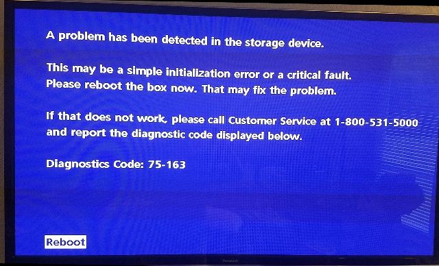

I just put a brand new 3TB drive in and got this error message.... rebooted 3 times and still getting this message. I'm assuming that I just figured out the HR24-500 can't support a 3TB drive????
I looked up diagnostics code 75-163 and it refers to the hard drive not working (I'm assuming they mean the internal HDD, not the external as it works fine when connected to several diff PC's)
It is an esata, yes? If so, 2tb must be the maximum.
yes, using the esata connection. Is there any other way to get up to 3TB?

I don't think that will work. It's the software limiting the hard drive to 2 tb.

NOPE, HR2x's software limited to 2TB, internal external or net RAID.
One may put > 2TB in place but only 2TB can be 'used' by the receiver.
