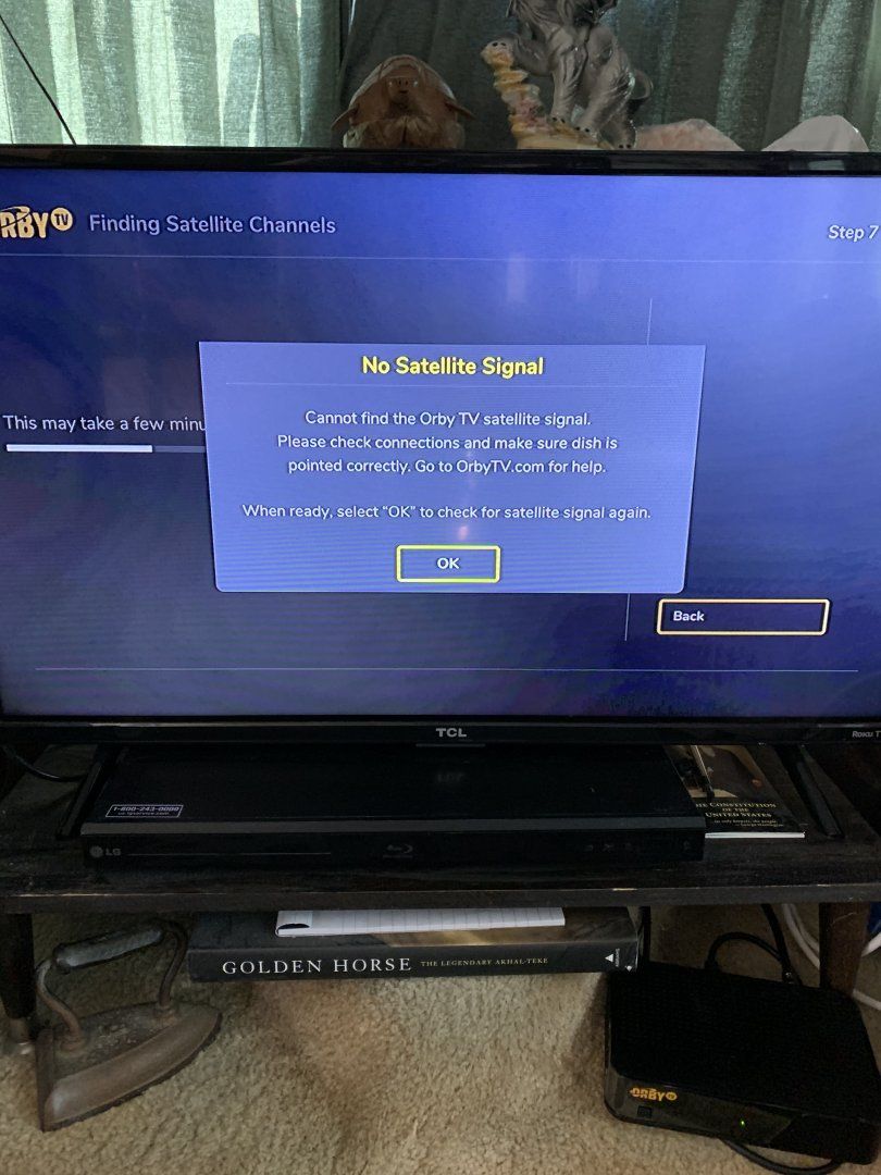

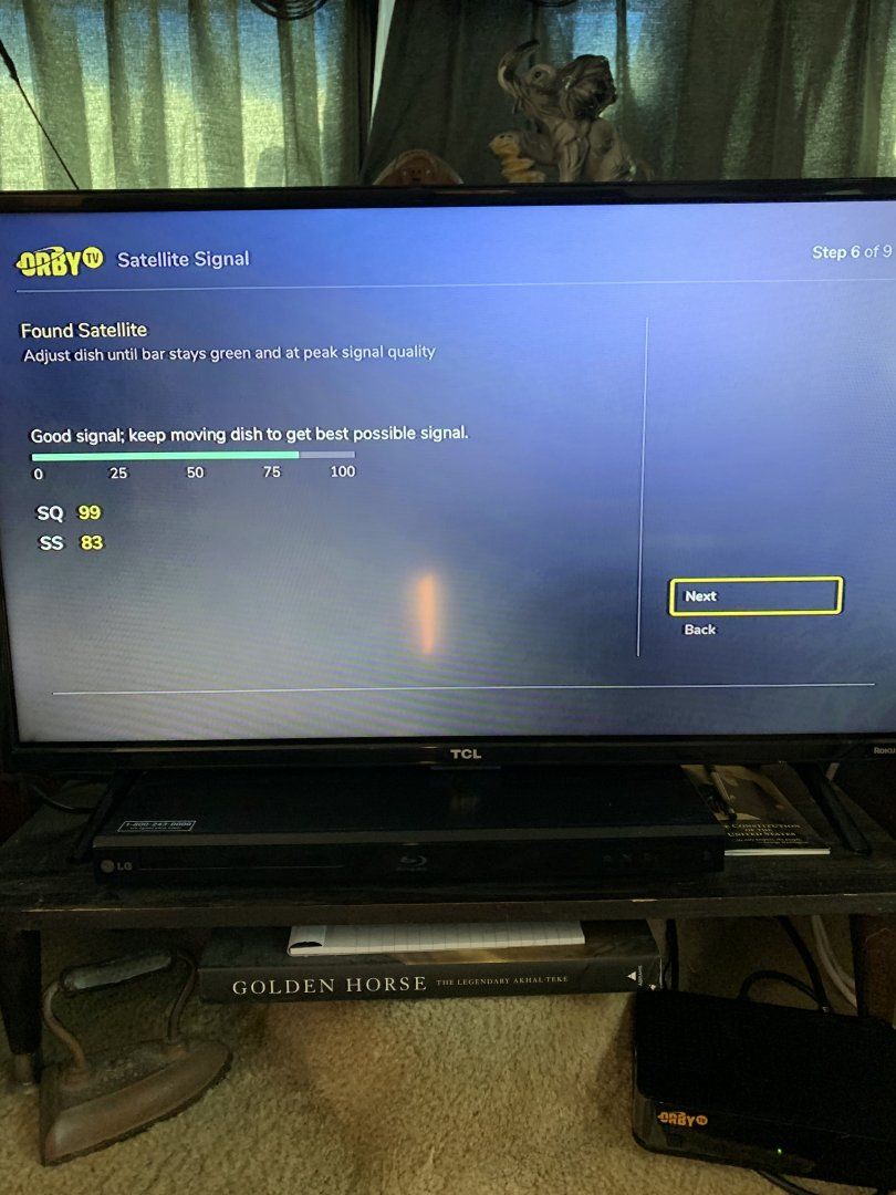

Moved the dish a couple feet. Checked plumb, level and all measurements then hooked up signal meter, which is def progress, but now stuck on step 7

pics attached

Looks like you had it then maybe the dish moved a tick before step 7. If you can get back to the picture during step 6 with both S and Q above 60 percent or so STOP don't touch anything on the dish. Take a black marker and index the mast and mounting bracket so you can go back if needed. The receiver should start working and should update. You can go back and re-peak but be careful as it is easy to loose the signal when tightening the mount bracket.

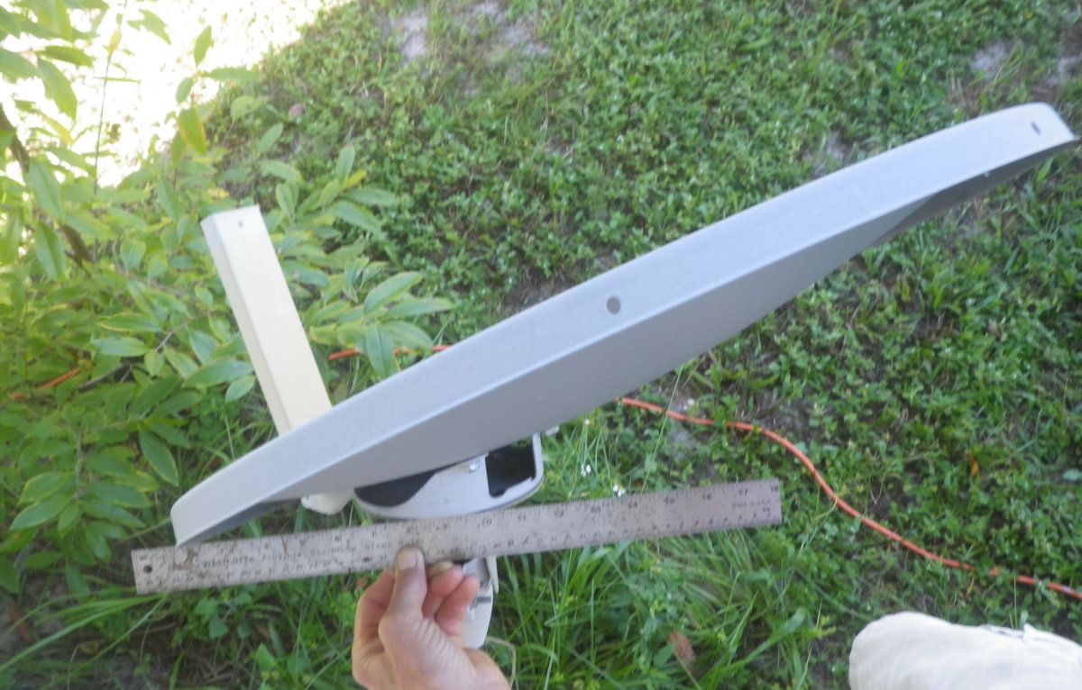

Just wanted to follow up with what NYdutch posted. I went out and looked at the only whole dish skew dish that I have - an old dish 500 that has not be in use for a long time but I believe it is on 110 and 119W the picture below shows how much the skew offsets the direction.
Maybe this will help someone else trying to aim a dish that uses whole dish skew.

I have four Orby receivers here that I installed and activated myself. That happened on a couple of mine as well. Really strong signal like yours but would not proceed past that step. I knew it had good signal so I kept going back and clicking next. After several tries it finally went past that step and all was good. Try that and it should go through. :)
