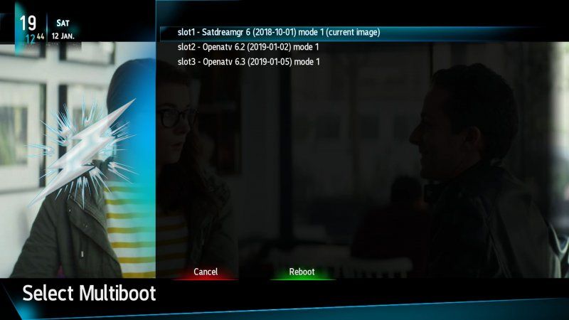

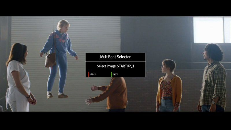

If you want to switch between the images, you can either unplug the box, plug it back in, then hold down on the MENU key on your remote. A blue screen appears which will allow you to boot whichever image you want. Or you can do it from within the menu in whichever image you are running.
This is what I do to switch Images:
If you are using the ATV image:
1- go to Menu>Standby/restart>multiboot.
You will see a screen like this:
Press the < > on the remote to select the images after selecting press the green button to change the image.

If you are using the SatDreamGR image:
Press the up/down keys on remote to select the images after selecting press the green button to change the image.

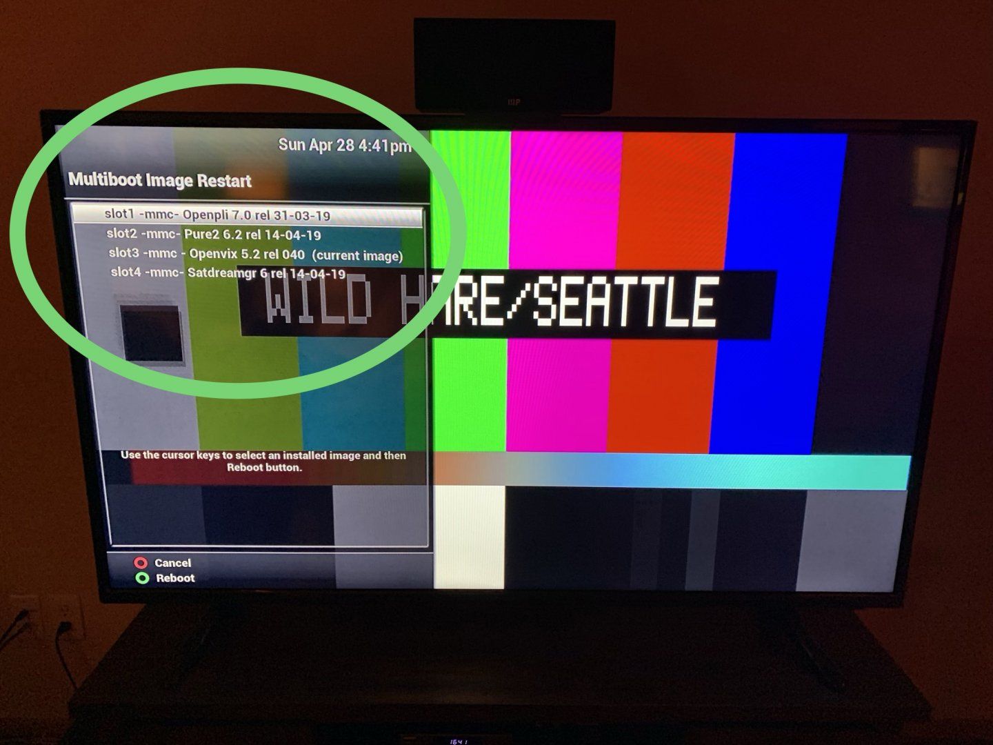

My guess is that's what my "problem" is with additional images? They all show up in the TNAP multiboot but not in the multiboot in other images even though those images have a multiboot option also. The other 3 images see the TNAP image but not each other.

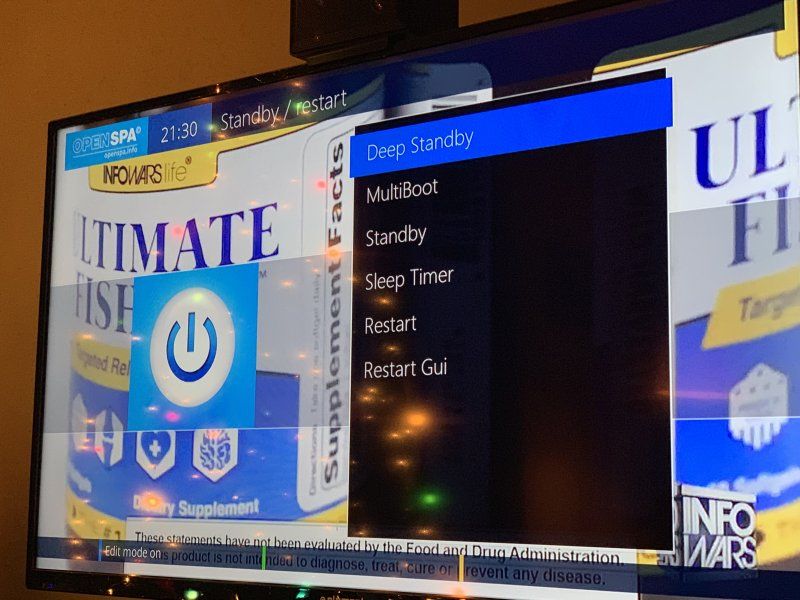

That's not what I'm seeing.
In OpenVIX, it's under Menu then select Standby and Restart then select Multiboot
