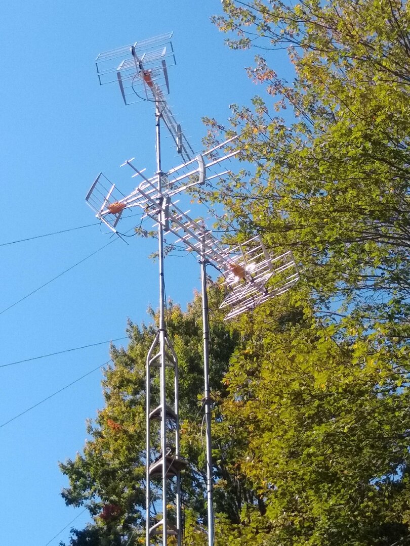

It's worth it, hands down, and it's a ONE-TIME cost, versus paying cable tv every month forever. Best combiner in existence, and I only wish it had been available 40 years ago. This is what I combine with it. Each pointed at a different DMA
View attachment 171344:

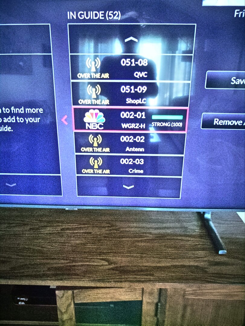

success! thanks guys long story short it works awesome. I bought the Televes combiner off Ebay "open box" it was missing the amplifier sent it back and bought a more simplified version just a 2 antenna combiner off Amazon Televes works fantastic. my NBC ,CBS, Fox feeds all read 100% signal strength! so should be able to watch sports in the fall without it is getting pixilated and glitchy!
NBC was the weakest signal on a good day no bad weather maybe 85% signal. the second antenna is pointed directly at the NBC local tower I didn't have to tweak the degrees put it right dead on the compass reading and wham a happy camper!!! :)
