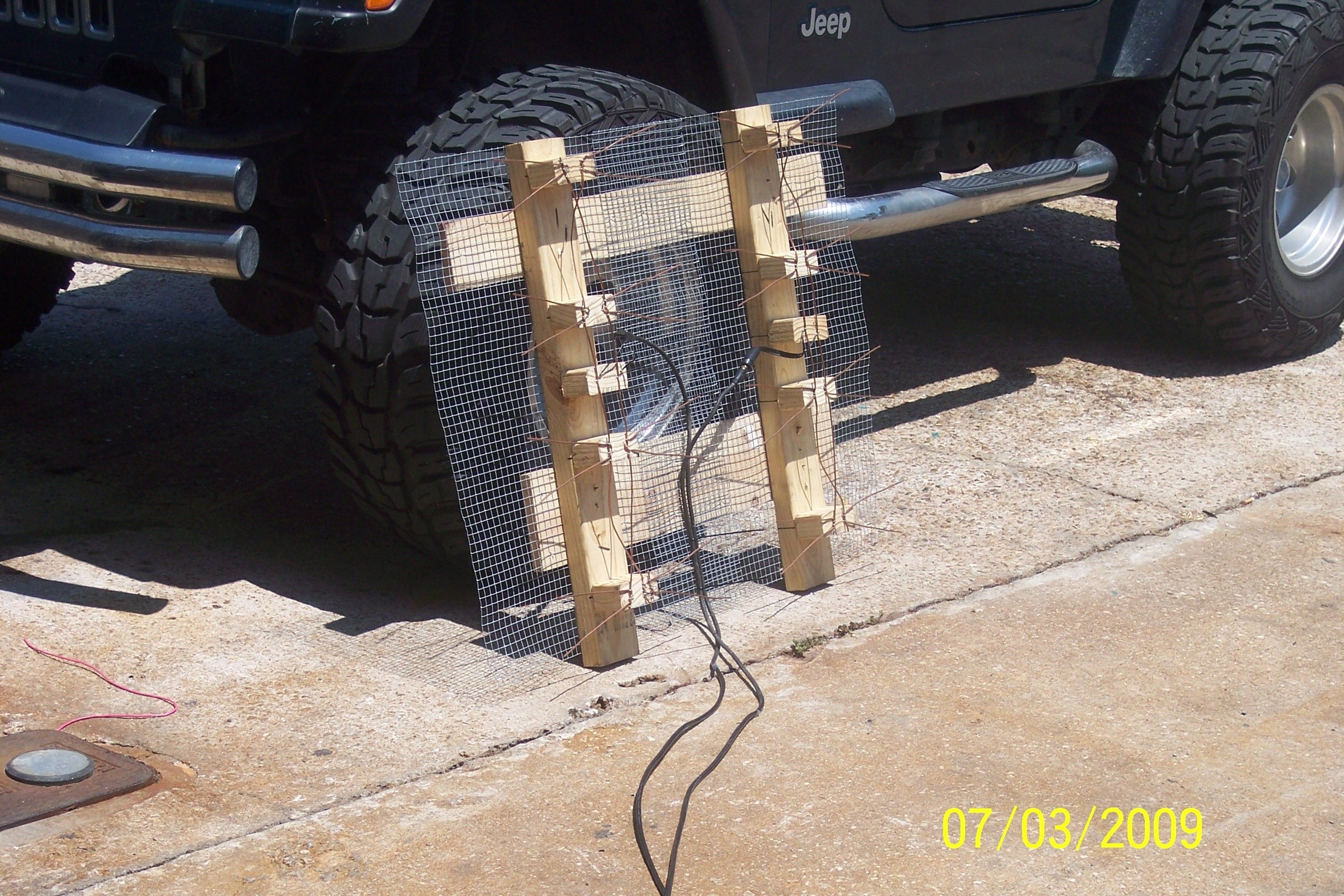

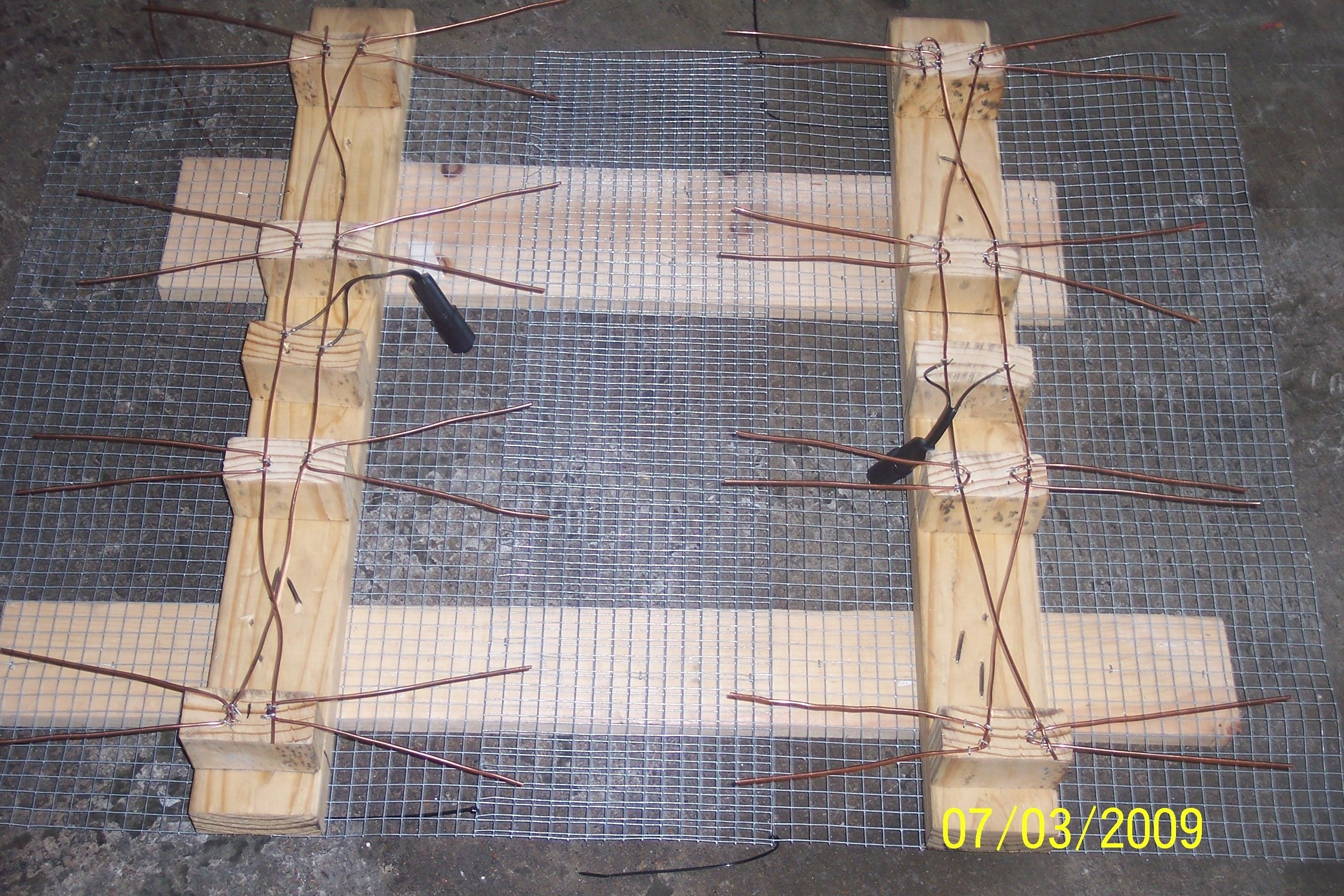

A two bay antenna. A good deal BUT I like my home made 4 bay better.

Yes the wires are stapled down but they need to be soldered to really work long term. I am about 38 miles out and have about 20 channels with my cheap conveter box.
