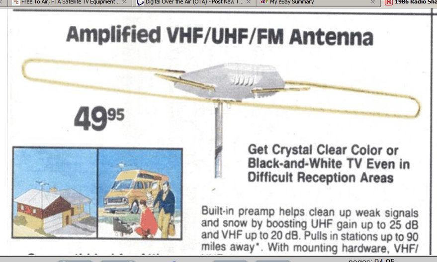

It may be of little hope, but if you find one of the old Radio Shack (made by Antennacraft) units like I use (and frequently find at garge sales, RV dealers and on the 'net) you wouldn't be disappointed! In the old days of analog TV, I got 60-70 miles of GOOD reception, and am currently getting multiple markets without a rotor. As far as I know the only one ever "shaped" like this was the radio shack or antennacraft, so if you ever see one, GRAB it! And, good luck with your project in the meantime!

So true! You still "can" get what they call the power inverter from summit source and others! Good Point, however. One Ebay seller had one, wanted TWICE what the asking price in that ad was, and didn't have the power supply. Needless to say, I didn't buy it.
If it's a common voltage,you might be able to adapt one from a different source.
I have an inline amp that is dead,but I am hanging onto it just in case I can use the power supply
inserter for something else.
Slightly off-topic, but...I was tempted yesterday to take pictures of the insides of the famous "Mini-State" antenna which RCA used to put out, and now is under a different name, I think. This is the "larger" garbage can style unit with the wired remote control and amp. A small motor rotates the elements in teh dome. In all honesty, I can see why, when I owned one (the one I had open yesterday had died) it was nowhere near as powerful as the old Radio Shack/Antennacraft RV antenna shown in the ad I posted earlier here! There is one driven DIRECTIONAL element laying flat on styrofoam in that dome, small "directors" glued-in, and a divided band of aluminum around the outer edge of the styrofoam drum. Really not much "meat" there to grab signals, and certainly not very "directional" even though it has a rotor! Apples to apples, the one I posted by antennacraft has more actual working "elements" and is likely tuned-better to begin with, and is THEN amplified.
