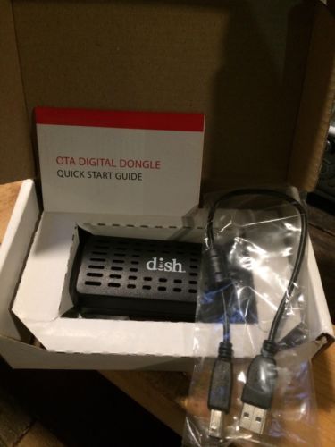

The dual adapter for OTA has a weak tuner. It's not surprising that your TV's tuner is better.

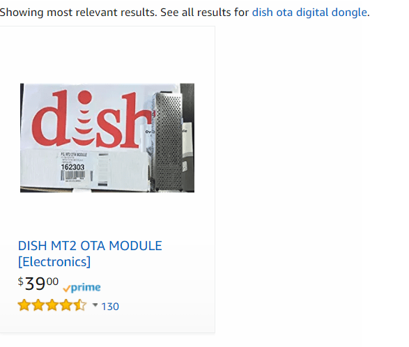

Do you know if there is there any way I could change to a better adapter? This looks like the one we have
You might be able to find one of the old single tuners on Ebay. I don't see any of them on there right now, though.
Debbie. That one on Amazon is not for the Hopper. All the previous comments are correct. I too live about 4 miles from TV24's tower and having the same problem. 24 cut there transmitting power in half and 12 and 54 have dropped as well. I have the usb dual dongle and it is not as sensitive as the single tuner. I continue to pay for locals because I don't like losing the on demand option for mobile and home also like the two tuner option. Our locals don't care because I think about 95% of the area has cable. And those subscribers don't have the option of plugging there OTA antenna into the cable box to record. The new 3.0 DTV system is coming in about 2 years. New equipment will be needed and they are moving the designated DTV channel number. Maybe all will be well by then. Sorry this post is so long but had a lot to say on the subject.

It's not a function of moving the signal meter to 40. It's the tuner itself. Adjusting the signal meter to 40 isn't going to fix the fact that the dual dongle (manufactured by Hauppauge, by the way) is weak and less sensitive than the older single tuner model.
