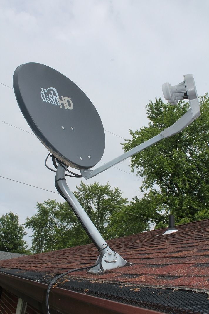

I have a question regarding mounting an OTA Dish Antenna (with a motor) onto an existing Dish antenna mount that is no longer being used for Dish Network. First of all, the Dish is mounted on my roof (see picture below). I am considering buying this antenna (see link).
Amazon product ASIN B004NQMCDK
Is this possible? And if so, what is the best way to go about doing this? Is it as simple as removing the Dish and mounting the OTA antenna to the existing mast? What extra equipment would I need?
Thanks in advance!
One caveat about that antenna, it is not very well made and may not last very long. Also check the pole size and make sure it is compatible.
Check into traditional, unamplified antennas for similar prices, small short range, same size , maybe cheaper.
Post your TVFool.com report and we can advise you. Use your exact address (it does not show on the report) for greater accuracy.
All of your network channels are just slightly north of west from you at 15 miles, all UHF, so a 2 bay UHF bow-tie type antenna like the AntennaCraft U2000 at $24.99; Solid Signal Xtreme HDB2X at $29.99; AntennasDirect SR15 at $39.99 or a small yagi like the AntennaCraft MXU47 at $49.99. Any of these should be small enough to be mountable on the dish j-pole.
