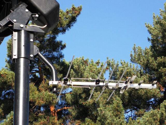

I'm in deep fringe area for reception and use an Antennas Direct 91XG for UHF, and a home made antenna simular in performance to a Winegard YA-1713 for VHF. These two antennas are fed into a CM-7777 pre-amp. My tower is currently 3 sections, with a fourth piece waiting to be installed. (currently about 35 feet) Height is important for deep fringe reception.
Making/using custom channel-cut yagis for UHF/VHF TV - Page 14 - Digital Forum
Hi-VHF 10-El Yagi - Lorkoe's Antique
http://lh4.ggpht.com/_xp43tcwB5ps/TBgusuw9whI/AAAAAAAABAA/nij0uopKPJE/s1024/IMG_6731.JPG
The laws of physics must be applied, so for long range you will need height to overcome the curvature of the earth, and a large antenna to get the needed gain. Do not look at any distance ratings, but rather the gain of the antenna.

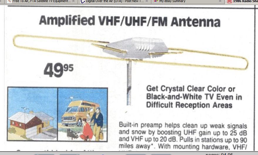

See attached. Still works well. Find 'em used if you're lucky! Antennacraft made 'em for RV's and boats, Radio Shack privately labeled 'em. I want to tear one apart and see if they can be simply re-manufactured on a small scale for friends... since they've been abandoned by the company for a long time (and I have friends that want them!!)
An abandoned product that really worked and one that SHOULD be "reverse engineered."
On an average one-story roof, its pulling two markets off its backside, and two off the front, the farthest on the back being around 60-70 miles. GREAT on UHF and VHF-high, which is why it works so well now for digital!
