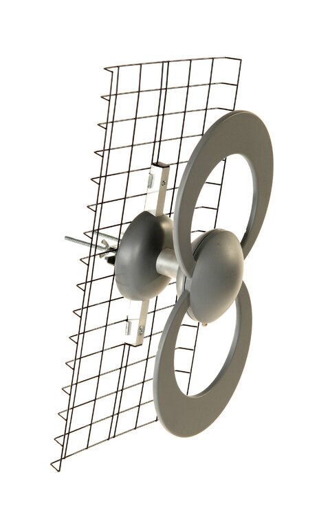

Your zip code would help. But your best bet is to buy a new ClearStream2 indoor/outdoor antenna from Antennas Direct.
The ClearStream2 has a range of up to 50 Miles in a small, but powerful 10" x 20" antenna. It has a beam width of 70 degrees, so it will pick up a wide range of stations.
Antennas Direct provides customers with a 90-day, no-fault return guarantee on all Antennas Direct antennas and a lifetime warranty against failure, corrosion, defects in materials or workmanship and will completely refund your purchase price, no questions asked, if it does not do the job for you.

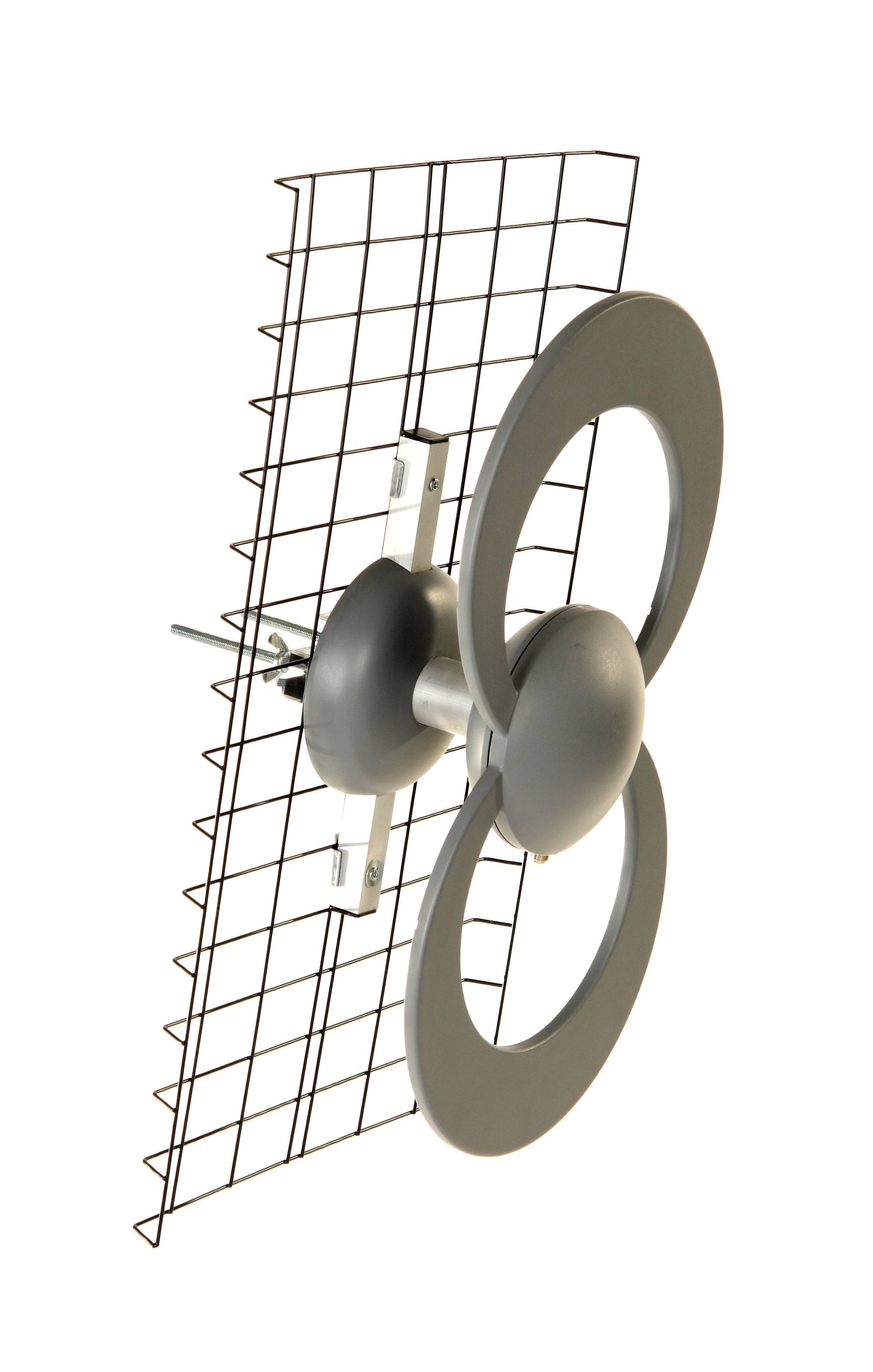

Your zip code would help. But your best bet is to buy a new ClearStyream2 indoor/outdoor antenna from Antennas Direct.
The ClearStream2 has a range of up to 50 Miles in a small, but powerful 10" x 20" antenna. It has a beam width of 70 degrees, so it will pick up a wide range od stations.
