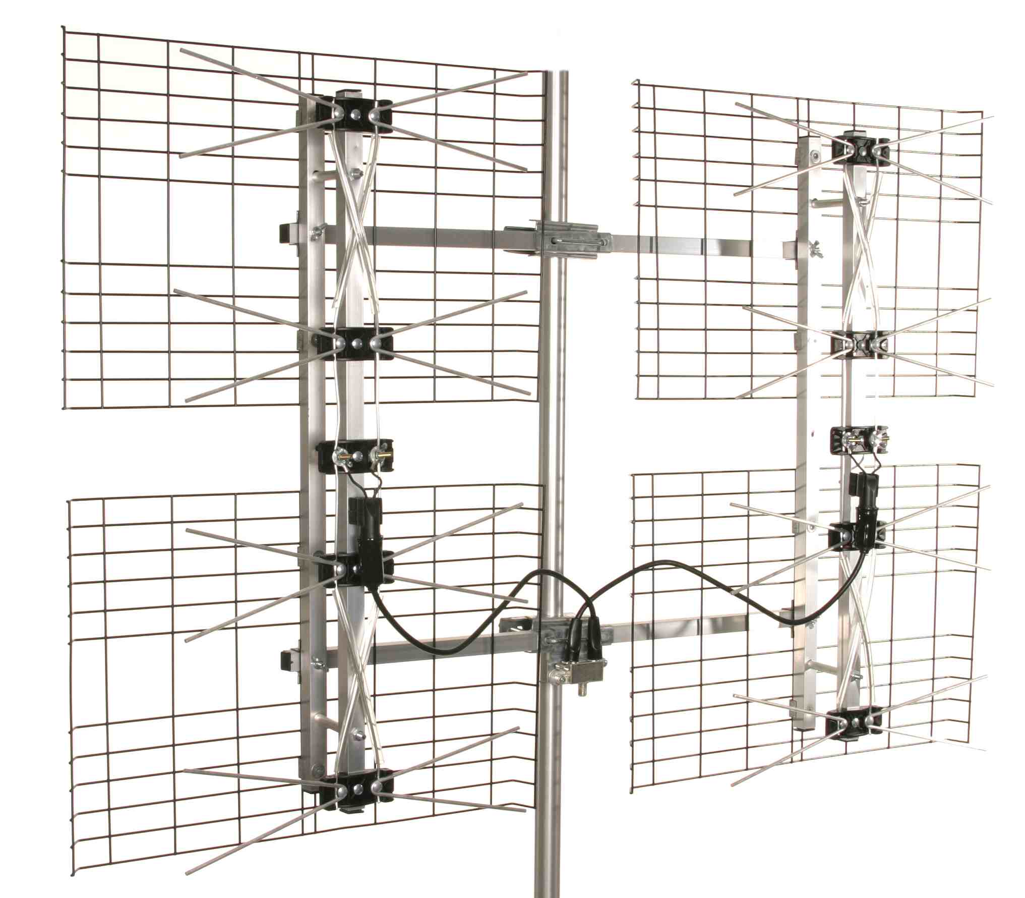

Do any of you all know of a good OTA antenna, UHF, for up to or a little over 60 miles away. My DMA is Roanoke/ Lynchburg, and I'd liek to get CBS which is broadcasting at full power at i think in the 500 kw area. The DMA that I am trying for is Raleigh/Durham DMA, because their FOX does HD now, and they are broadcasting at 1000 kw making it easier for me to recieve them. Are any of you all as far away as I, and if so which antenna do you use.
Currently I am looking at that Channel Master 4228a.

Fgsilva said:
Forget RatShack products for this distance.
I would first call the station engineers and ask them if you are in the "Grade B contour of their digital signal". If the answer is no, put away your wallet.
If the answer is yes, go for separate, not combo, VHF + UHF antenna from Winegard or Channel Master with booster (only if you need it) from Channel Master or even better from Blonder-Tongue
