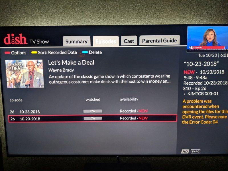

I will definitely try your autotune trick. I tried a recording today as a test and received a new issue. The DVR only recorded 15 minutes of a 60 minute show displayed an error in the recording information. "A problem was encountered when opening the files for this DVR event. Please note the Error Code: 04"

I have also seen that Error Code: 04 on OTA recordings. This happens when it first starts recording an OTA channel, and it looks like the recording is split into two segments, but the first segment is less than a minute (more like a fraction of a second) which is why the start and stop times for that segment are exactly the same, and no recording length is displayed. (Using your picture as an example, the length of the recording would normally be where the dot is, next to "KIMTCB 003-01" in the info on the right-hand side.) This happens regularly on my Hopper Duo. This also used to happen to OTA recordings on my Wally, but that issue seems to be fixed lately for me.
