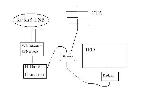

Diplexing DOES NOT work with the Ka/Ku DBS setups. You will need to run dedicated OTA RG6.
Diplexing will work as long as you install the b-band converter before the diplexor.
See attached illustration

But I wonder how long those BBC's will last when exposed to the weather?
Indoors would be best, no doubt. When I lived in NY my multiswitch was in my basement. So weather would not of been an issue. The one I did for my friend is outdoors. Only time will tell as to how it stands up. I did tape the living hell out of it though as to keep rain from it.
