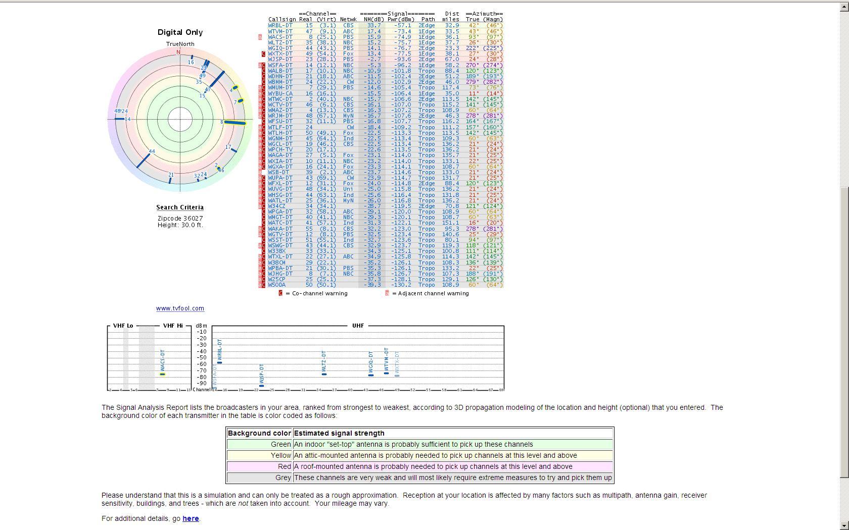

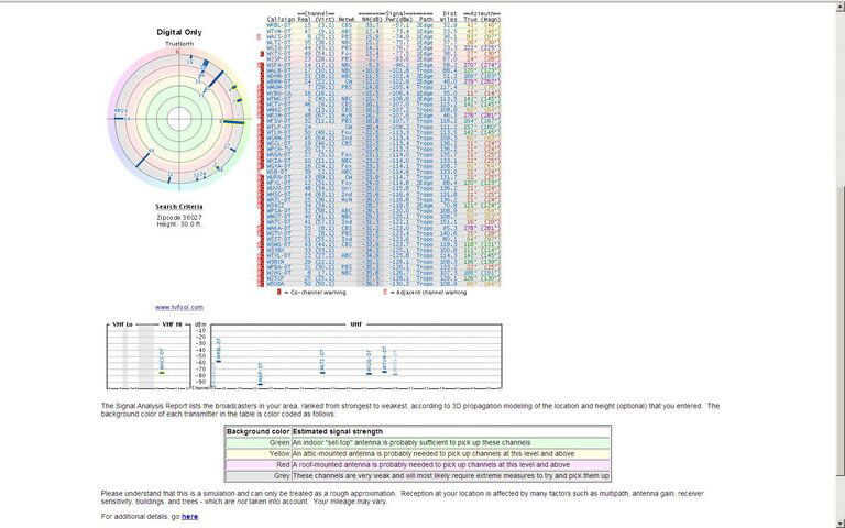

The TV FOOL profile that charper posted indicates sufficient signal strengths for reliable reception of the "big four". You should be able to receive 7-8 stations reliably with the right setup. (According to the zip code supplied; an exact address would be better)

I punched in 162 Cottonhill Rd and I am seeing more terrain issues than before. There are some obstructions between you and the transmitters; but the signal strengths are still favorable for 7-9 stations.
Is it possible to test your analog reception? This is usually an excellent parameter of how your system will perform with digital reception. Look for multiple images(ghosts) or other kinds of interference.
