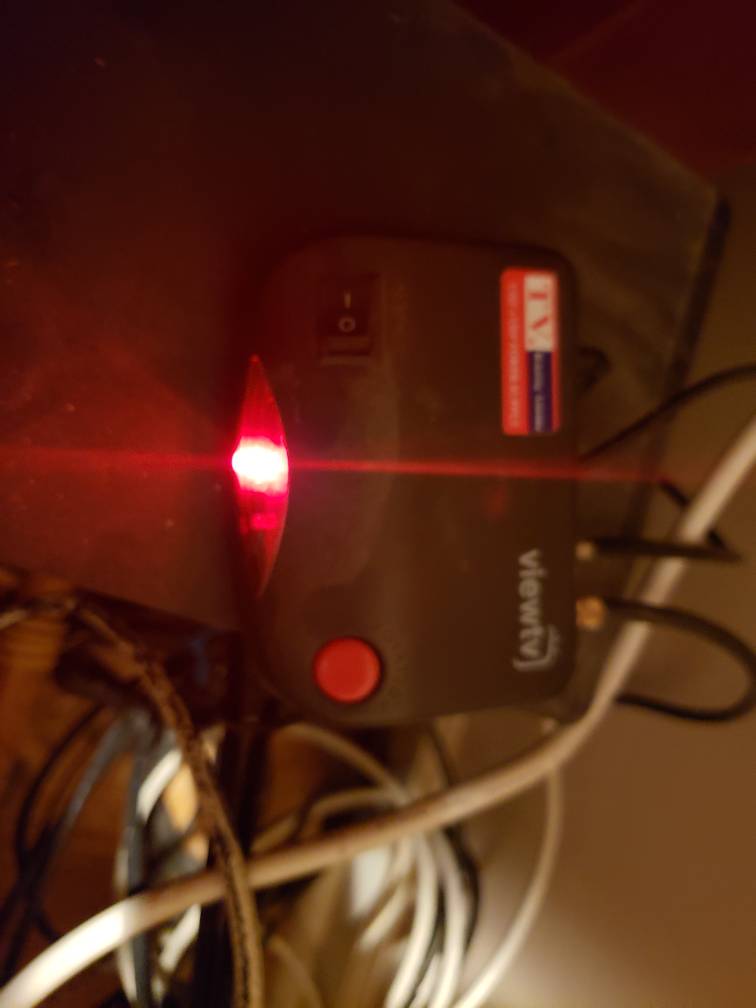

Just curious, what cable did you change?
It's hard to see but their are 3 wires coming out of the antenna amplifier. One is the power. One is a homemade cable segment. The other is a hard wired cable coming out of the amplifier, very thing and cheap.
The only reason I put the cheap cable to the Hopper adapter was because of length. When I took the homemade cat6 cable off the TV and put it on the the Hopper adapter it improved things.
This doesnt adress why changing cables made me have to reboot even with 100 percent signal. But oh well. If there's a faster way to cycle it would be nice to know.
This doesnt adress why changing cables made me have to reboot even with 100 percent signal. But oh well. If there's a faster way to cycle it would be nice to know. View attachment 141098
Sent from my SM-G965U1 using Tapatalk
I always try turning it off (standby) and back on again before rebooting. For me that fixes a lot of OTA and MultiView 'inconsistencies'. :)

I hate to say it, but the problem may be your antenna amplifier. It might be clipping on a strong local channel which can cause all sorts of issues receiving a good, clean ATSC signal. Have you tried taking it out of your signal path?
No. It doesnt work without it even on the TV. It's designed like that.
That's an interesting idea. But this thread isn't about signal. It's about good signal but the Hopper had to be rebooted to show a picture and not complain about not having signal.
I doubt there is an answer to this but it might be an operating system problem. They should be aware of it.
