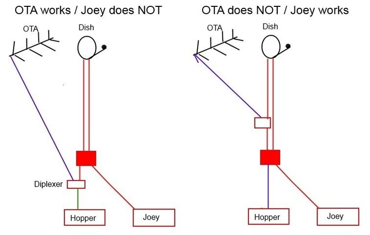

I have a single Coax cable that run to the Hopper and a single Coax cable that runs to the Joey.
Dish can not figure it out and I hoping that someone here can.
I have the OTA module plugged into the USB port. I have tried a few different configurations but can't get OTA and the Joey to work at the same time.
Any anyone help or will it require me to pull two Coax to the hopper?

That may work then. If I unplug the Joey from the Coax and plug it into the Ethernet network. I can then plug in the OTA antenna (just like the diagram on the left in m first post) and get OTA on the Hopper via Coax and then steam to the Joey via Ethernet.
I'm going to try it and see if it works
Sorry, I didn't look at the pictures the first time. That won't work. You can't diplex the ota in with the sat feed to the hopper. You'll need to run a second coax into the room. Or try a simple indoor ota and see what you get. I use a tv2 remote antenna off an old 722 as my ota and get about 20 channels.
I believe the moca and the ota run at a similar frequency, and it's muddling the moca signal, causing joe to not work.
Basically no way of using that OTA module unless you connect it to the Hopper and have a second cable from the antenna to the module.

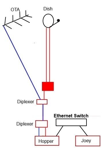

Come on you guys! If your Joeys are connected via your LAN, then you can put an isolator on the Hopper to kill the moca signal, and then diplex as usual (past the node). I think you could even get away with diplexers alone, though that would mean you are radiating the moca signal out your antenna. ;)

It seems to work just fine when I set it up like the image on the left. I get both Sat and Antenna.
How do I go about "kill" he moca signal? Do I even have to?

SUCCESS!!!!
I was able to get the Joey and Hopper to work via the Ethernet switch AND the OTA Antenna to be seen at the Hopper.
That's the whole point! Kill the moca signal so you can pass your antenna feed over the same line as the Hopper. Probably you couldn't do that because you didn't have the Joeys connected via your LAN.
I tried that very thing last year and it killed my Mocca signal to everything including the hopper. So I couldn't do that.
However it doesn't kill the Ethernet signal :) .
Yep. Once past the initial installation wizard and the latest software is downloaded, no need for MoCA at all.

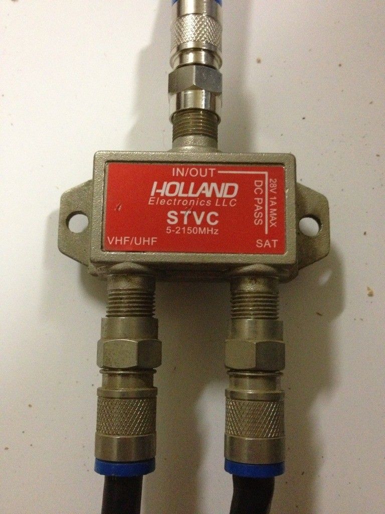

No sure if it matter but here is the DiPlexer that I used and it works perfect. View attachment 85967
Yep, that's just your standard Dish-supplied diplexer. Nothing special. Very neat that it passes 3GHz even though it's only rated for 2.2GHz!
