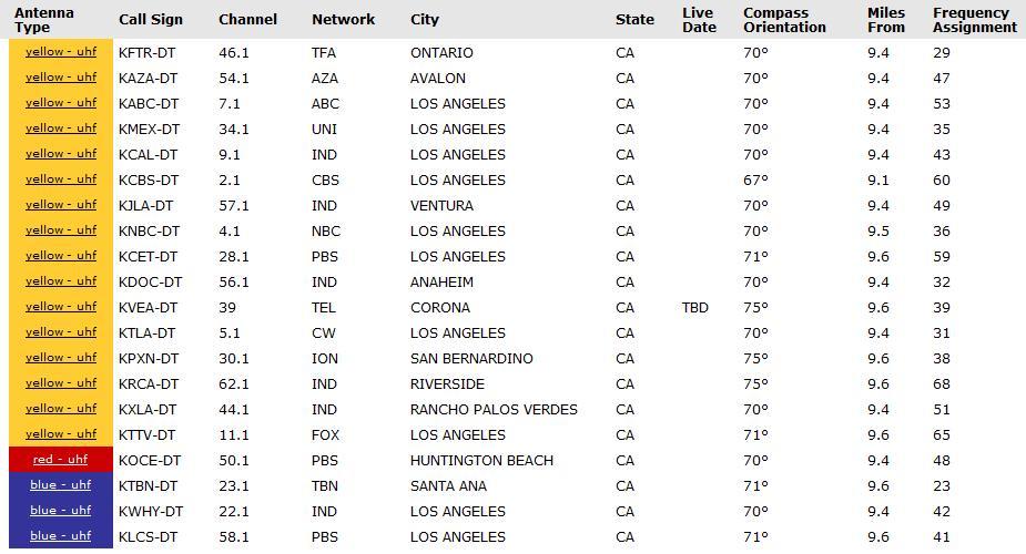

Looks easy enough; I would try the CM4221 or CM4228 aimed at around 71° or so (test it out).
