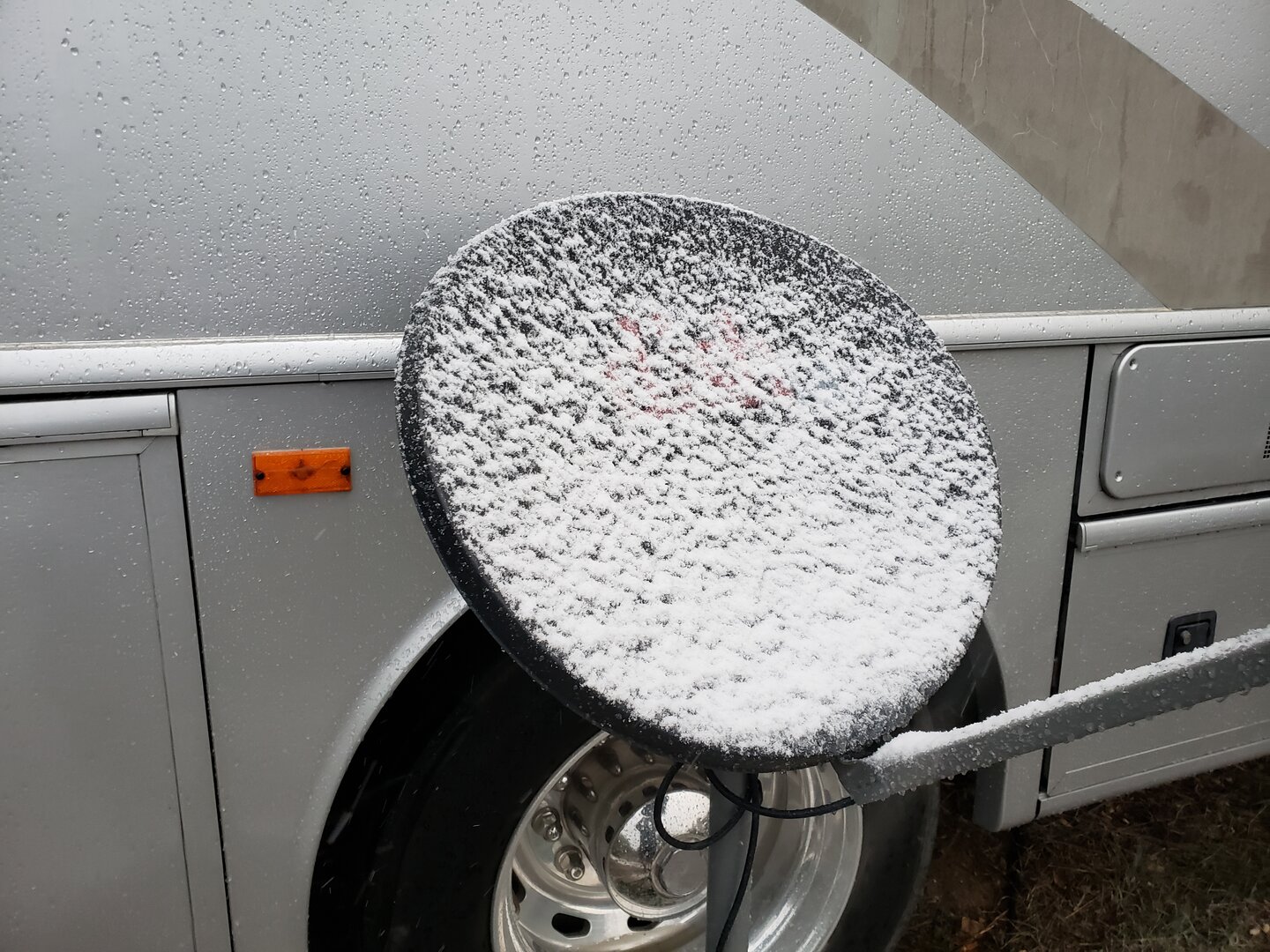

I did a couple of things I painted my 1 meter Ku and relocated it.
Is it possible or likely that painting the surface of the dish caused a problem? Signals aren't good

Very unlikely that painting a dish would make a difference with reception. The only way paint could affect the signal would be if it contained metal and it was very thick or uneven.
Its much more likely that either your dish is not aligned as well as before, or there is more interference at the new location.
Also you might want to check your RG6 cable and connections.
And one thing that I learned the hard way - a sharp bend in the cable can cause problems.

I have a snow problem only a few days a year. Snow at my location always starts as a rain then sleet and finally a very pellet like snow. Never powder. I have tried stick on reptile heaters trash bags you name it none work. What about removing the paint and polishing the metal? Or would the reflection of the sun burn the LNB? Is that way its black?
Not a good idea to remove the paint and polish the metal. As you mentioned the sun shining at the right angle could damage your LNB. Have you tried anything like this?
